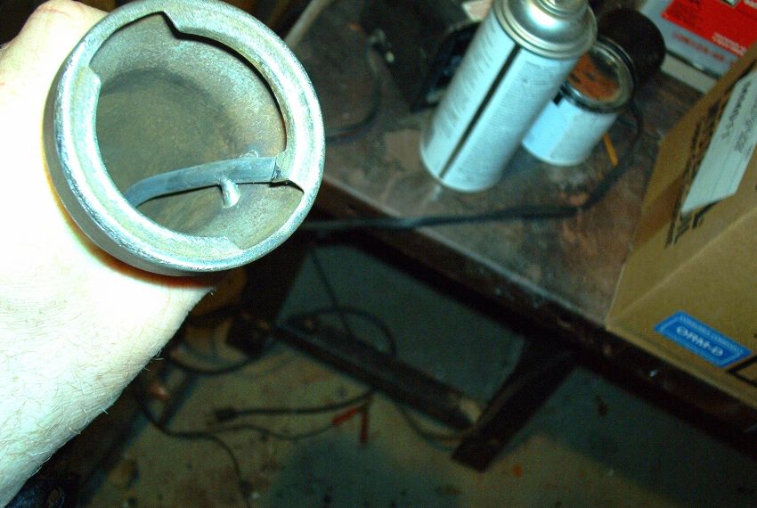

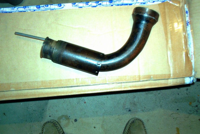

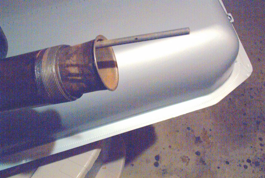

I had the same problem. I think it is a combination of too small of a factory vent and the fast pumping of modern station fuel pumps. What I did was add a 1'4" tube inside the existing neck (note pictures) and the problem was solved. Now I can pour gas in the car without having fuel backing-up and flowing down on the fender. Tom

Picture #2

Picture #3

Great idea and pics. Thanks
