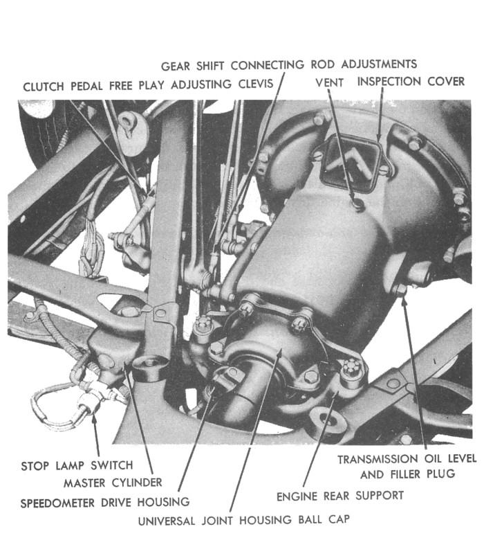

I need to replace the shifter shaft seals, p/n 7288. I'm not sure whether I can get the shifter housing off the side of the transmission, because of the closeness of the brake shaft and arm. I don't want to try until I know it is possible to get it off and back on, because I would likely break the gasket and then more fun. Has anyone done this and how was it done?

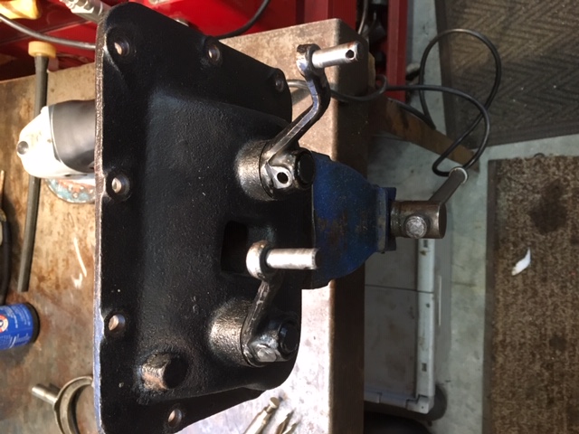

The trans shifter seals are replaced, thanks to a combination of ideas from 42merc and supereal. No way could I have done the seals in place, as the pins that hold the arms on are riveted. To remove the shifter housing, I removed the floor pan, disconnected the column to trans rods, removed the bolts from the shifter housing and tried to get the assembly past the frame/brake arm parts. No deal. What worked was lowering the housing and tipping the top away from the trans, which allowed me to pull both shift forks out of the shift cams. This allowed clearance to bring the housing up and free. I took the shift fork out to check them. The shift levers are held on the shaft with riveted pins, which I ground and punched out. One of the shift rod pins was loose in the lever, which I tightened by heating the riveted head cherry and peening. The seals I took out were original FORD, and looked like they were leather. New seal installed and shift arms reinstalled using roll pins, in place of riveted pins. Now the trick was to get this all back in place. Put the housing down in place (with gasket glued on) and tipped back at the top to allow install of the two shift forks into the shift cams. Make sure the forks are in the grooves and that the 1st/rev. fork is in the right orientation. It is a bit of a challenge to hold the housing and manipulate the forks into the cams, but worked okay. I put two bolts in the housing then checked for proper shifting. All was good.
