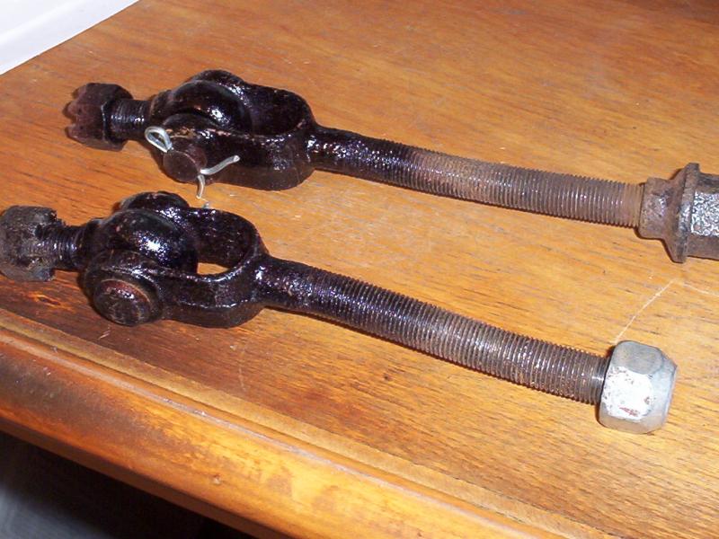

I thought I seen where someone was in the process of making and reproducing these bolts but can't remember where?Anybody got any information on these?I think maybe this Horse has been beat to death over the years!Theas would be for a 1948-1952 F-1.

my hangers were so bad from being dragged down rutted roads that I cut off the bad threads and welded some fine thread allthread cut to length. had to repair the cross bar that holds the tire it was also beat to cr*p
