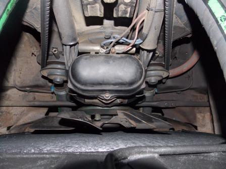

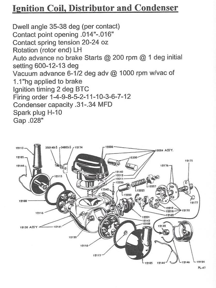

Hello All, I am willing to change the contact points of the 1948 Lincoln V 12 and have never done this before. Can someone walk me through this an easy way. Need the distributor be taken out of the car to do this right? What is the way to set piston 1 at Top Dead Center. In the attachment a copy of the information I already have. Thanks Andre Belgium

An other picture. Andre
andrefordt |
10-24-2016 @ 3:22 AM
Posts: 3
Joined: Oct 2016
and the information I already have. Thanks
ken ct. |
10-24-2016 @ 4:15 AM
Posts: 1513
Points must be sincronized on these ok if you have the machine to do this. Otherwize not a DIYS project. These are not like a ford setup. ken ct. PS hes lucky to have found a new set of points. The spring part is same as ford but not the scr*w*d down part.
This message was edited by ken ct. on 11-7-16 @ 12:56 PM
TomO |
11-07-2016 @ 9:29 AM
Posts: 7250
Ken is correct with his statement that you need a distributor machine to synchronize the points. Remove the distributor and coil and send them to Skip Haney in FL. He will set up the distributor and check out the coil for you. You do not need to have no 1 cylinder at TDC in order to time the engine or replace the distributor. It has an offset tang that mates with a slot in the camshaft to ensure that the distributor cannot be re-installed out of time. Fine timing is done with setting the break time of the points on a distributor machine. The easiest way is to remove the plug from the no 1 cylinder and crank the engine until you feel the compression stroke, the make the tool described in this post. http://www.toolsandgarages.com/index.php?topic=653.0 To make it easier to install the distributor, buy some 1 1/2 bolts that are the same size as the mounting bolts for the distributor. Cut off the heads and cut a slot in the end of the bolt. Screw the bolts into the timing cover far enough to support the distributor. Slide the distributor onto the bolts and turn the rotor until the tang seats in the cam and the distributor is flat against the timing cover. Then remove the cut off bolts and replace with the correct bolts, one at a time until the distributor is firmly mounted in place.
