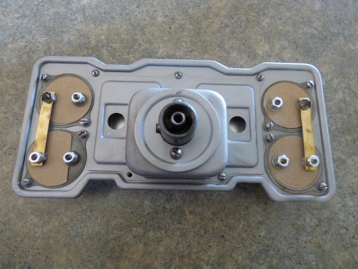

How do I go about removing the speedo and gauges cluster?
kubes40
08-19-2021 @ 9:21 AM
Posts: 3394
From behind... four nuts. If memory serves, a 3/8" wrench is required.
Note the four areas that are curved somewhat inward (two at the top, two at the bottom)... that's where the nuts are. Each nut holds a small metal plate that subsequently holds the gauge cluster in place.

A good 1/4" drive nut driver with a 3/8" deep well socket will do the job. I found it easier than using a wrench.
