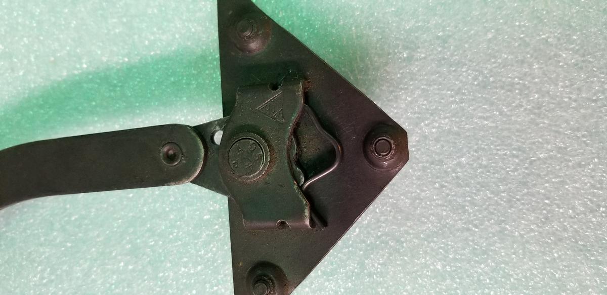

Mike, can you send me a picture of the spring installed, I un-tabbed the unit and I just need to make sure I am installing the spring correctly.

Steve, I don't have any photos of this. The photo you had provided previously should help you. The spring can go in one of two ways. That depends on if it's the left or right door. The small straight part of the spring goes within a slot in the cover you had removed.

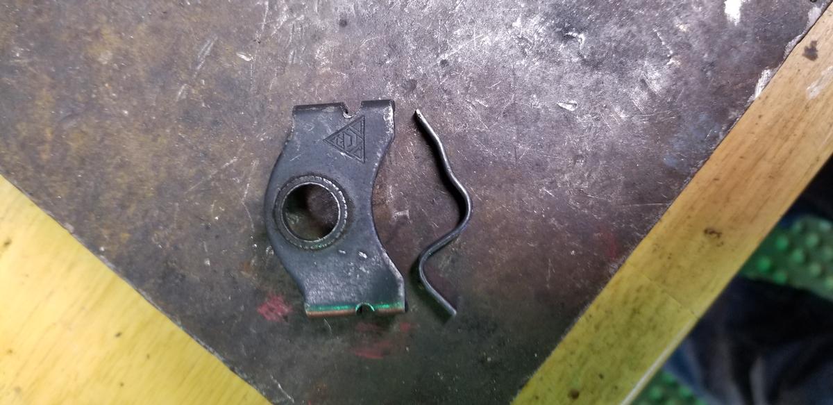

MIke, can you if you have time give me a call on my cell so I can get this solved. An issue like this is easy if you have done it previously or the cop out way is to buy new, I will not do this.
I have taken apart the cover and have uploaded the picture.
