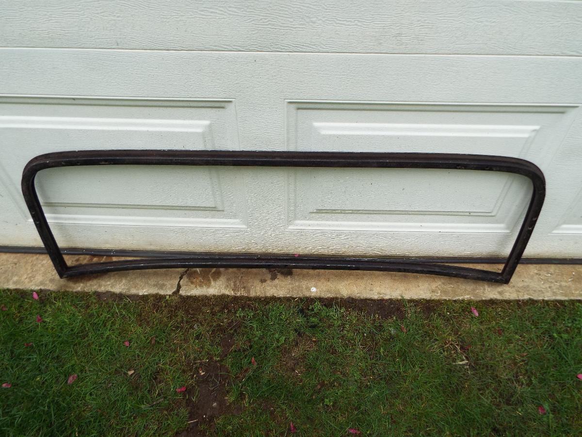

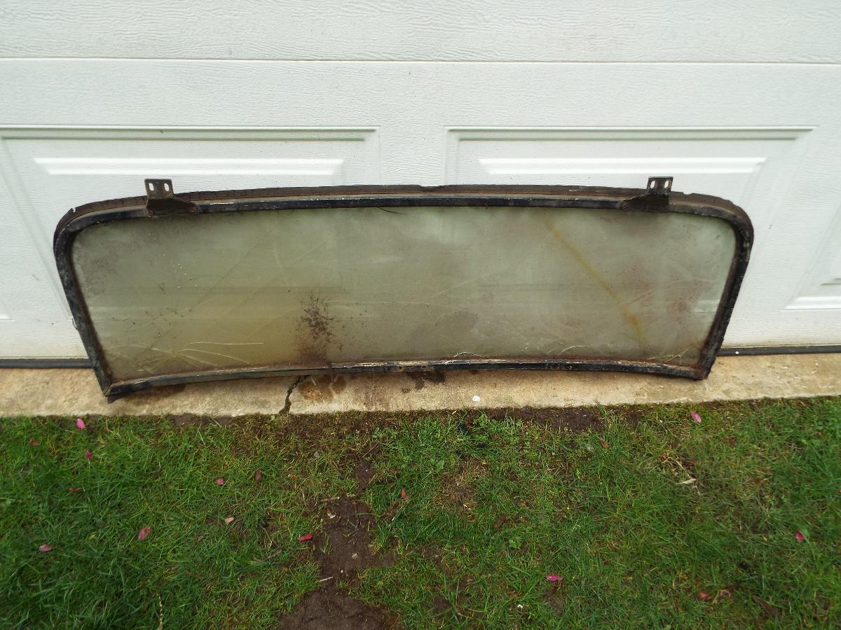

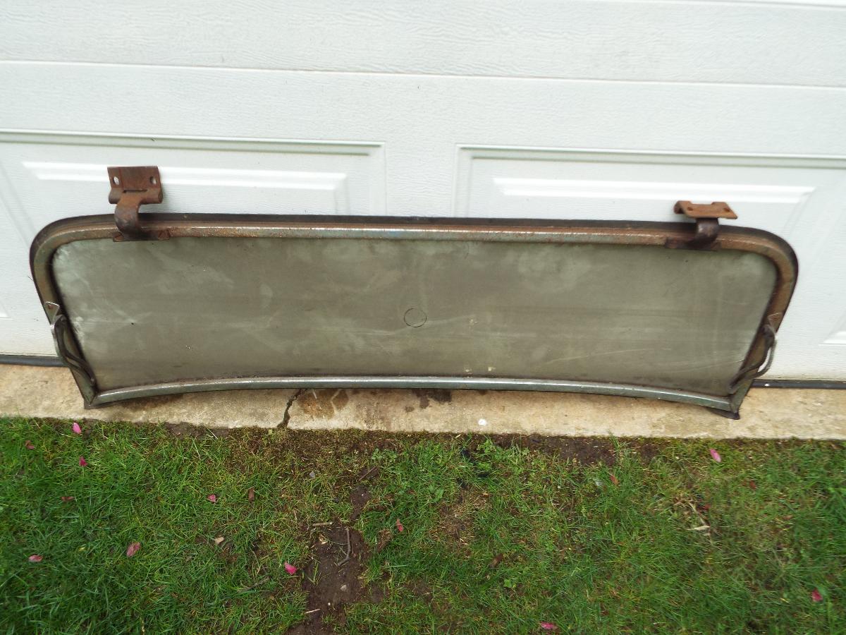

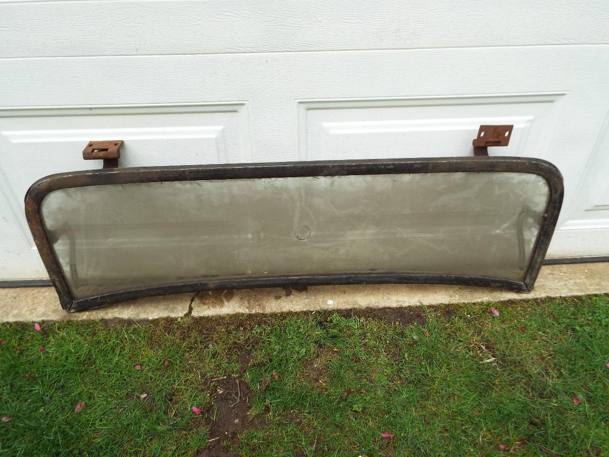

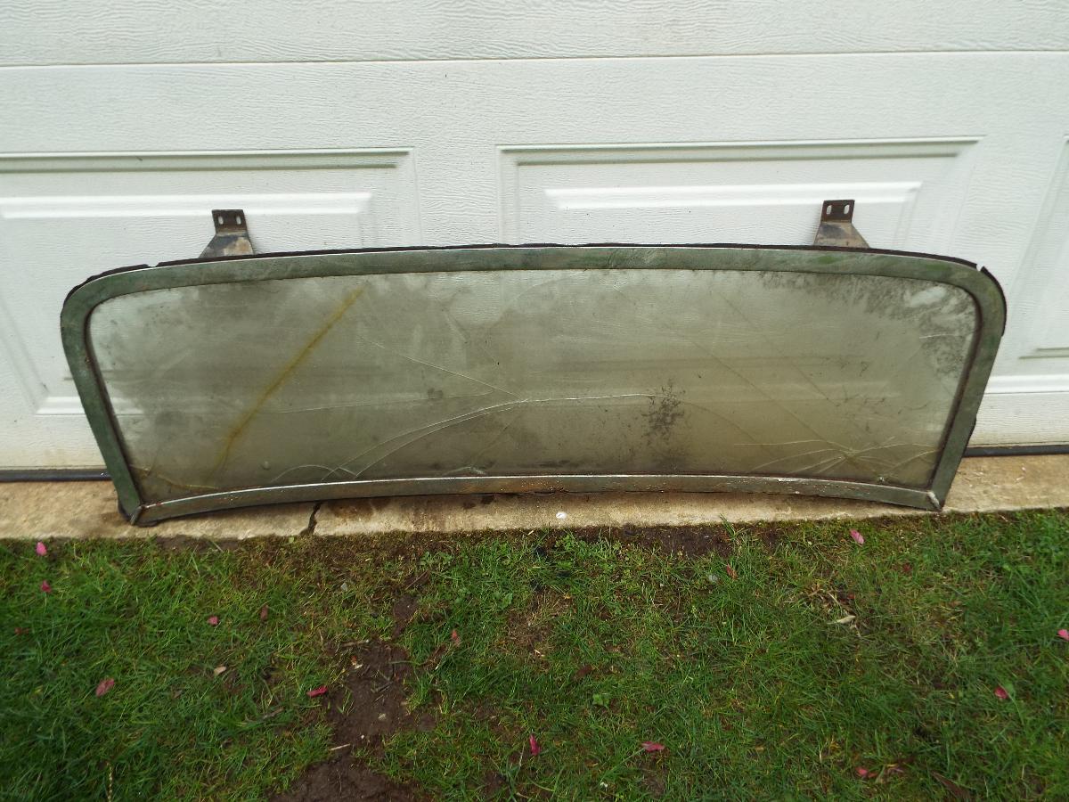

I would like to sell these windshield frames, but do not know for sure what they are. Please help me identify and even suggest a fair market value. Thanks
The one with the hinges and the black one with no glass are both 43 5/8 inchs wide at the bottom, and the one with the solid bracket is 42 3/4 inches wide at the bottom.

The one on the far right and far left is for a '32 deluxe coupe (3-W) and the other with brackets is for '33-'34 closed cars. It's only a guess on the black one without the glass as the brackets are a major tell tale and they're gone, but given that it is flat across the top it could be for '32 closed cars other than the deluxe coupe.
