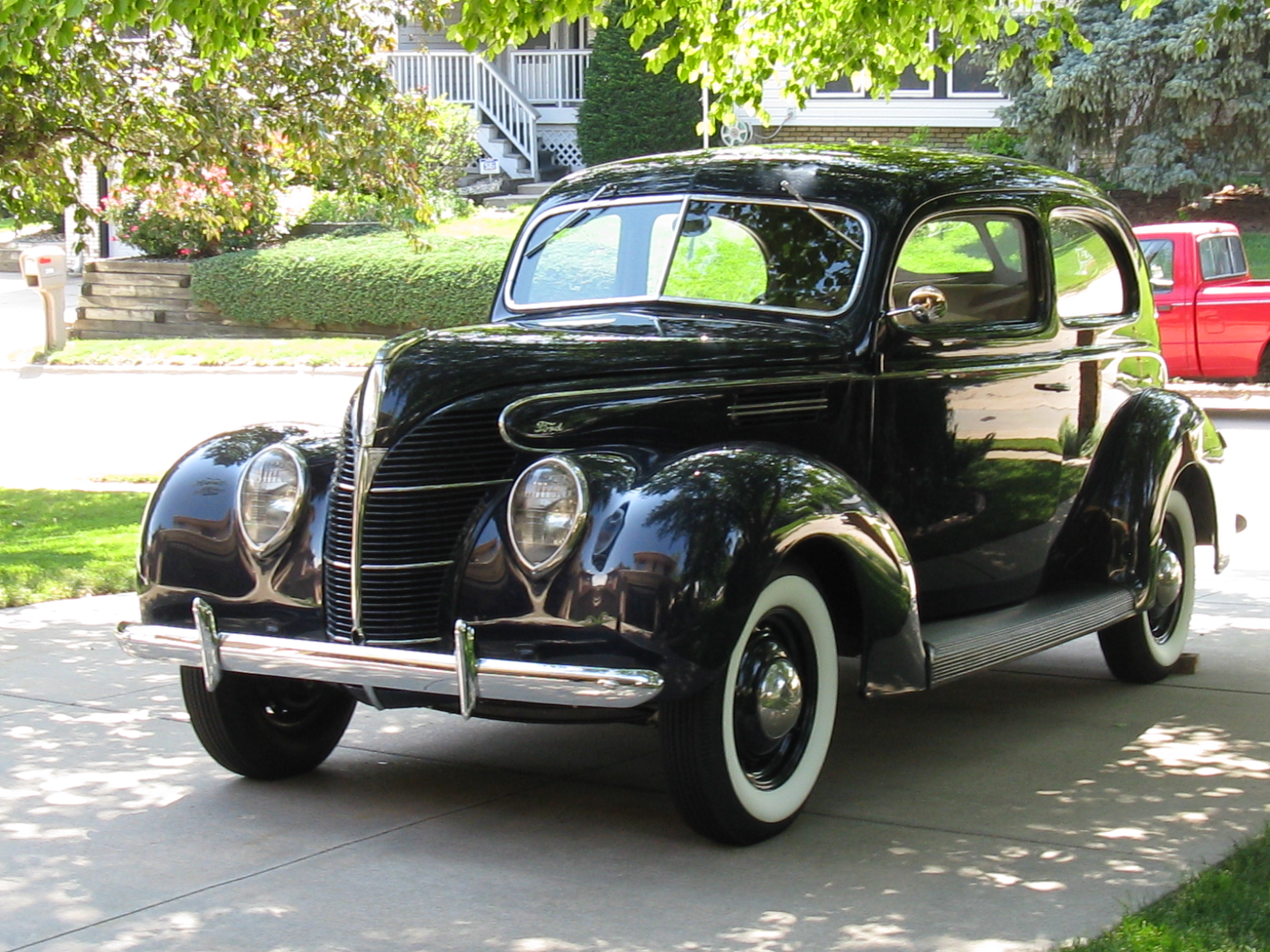

I have been restoring a 1939 Ford tudor standard since 1990, but that's a story for another day. The engine is a rebuild 100hp flathead. Over the years I have gotten all kinds of advise about what kind of fuel to use. I have stayed away from Ethanol but now I find that even regular gas has ethanol added to it. What brand of gasoline do you recommend? Is Sta-bil 360 Ethanol fuel treatment something I should be using?
