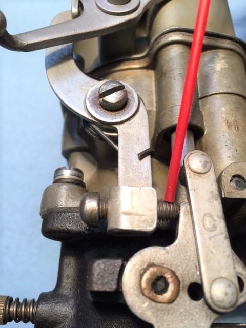

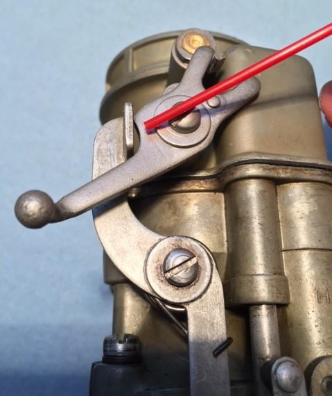

You need other words to understand the choke besides the one for starting. Look for the "unloader" and the "fast idle". These terms relate to the sort of vertically forked silver colored cam that seems to almost surround the choke arm at the manifold end of the carburetor and opposite to the throttle ball end arm. It has a linkage that goes up to a little floppy circular with a tab that is attached to the choke plate axle. There is a second screw besides the idle rpm screw that keeps the engine from stalling by raising the idle speed. None of these things are inside the driver's area. They happen under the hood when the carburetor is set up properly and the choke is manipulated to take advantage of it's features. For instance, it might seem like stepping on the gas before attempting to pull out the choke is to use the accelerator pump (another thing on the carburetor under the hood, is to squirt a shot of fuel to begin the enrichment) Actually this action unlatches the choke cams to allow the features I have described to take place. This then makes the engine seem to race a bit when first started which is why the driver might push in the choke to slow it. But because it is a on a different screw you have to move the choke knob a lot to get it so slow a bit. Once the engine warms up is when the "unloader" feature comes into play and causes the engine which seems to surge and slow and even lope a bit and smoke and gas smell if you are too slow in backing off the choke.

I'm not sure what therunway is referring to about "the second screw". Assuming you have a stock carb, your carb will only have one idle speed adjustment screw, and that screw is on the intermediate arm between the choke actuating lever and the throttle plate lever. That screw is used to adjust the idle speed when the engine is warm, with the choke in the off position. When the choke is engaged, the lump on the choke lever is what causes the intermediate arm to slightly rotate in the clockwise direction, causing the idle screw to push on the throttle plate lever, causing the engine to idle faster.
