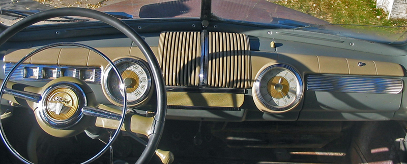

Posts: 738
Joined: Apr 2010
The dashboard color scheme was grey/tan. That didn't mean the plastic grill and trim were grey/tan. The metal was grey. The plastic grill and trim were tan, more accurately khaki. See picture attached (ignore steering wheel. It's not the right color. Should be grey). Here it is from Bob Drake: https://www.bobdrake.com/FordItem.aspx?Item=6A-7004401-SC&ReturnURL=/Categories3.aspx?Id=4248dash-panelsandtrim&Category=86767c6a-dad5-4aeb-b125-9596b52aec89 Oops. Says out of stock. Here's a nice one on ebay that comes with the speaker grill chrome trim: http://www.ebay.com/itm/Ford-1946-1947-1948-plastic-dash-trim-/132072720764?hash=item1ec025c97c:g:f44AAOSw4DJYe-PB&vxp=mtr And, if that chrome trim piece isn't good enough, you can get a new one here: http://cgfordparts.com/ufolder/cgcat.php?searchtype=Search&year_choice=47&searchtextdesc=speaker+grill+trim&sd=Search&searchnumber= Just need this plug for the antennae hole at the top of the grill trim piece: http://cgfordparts.com/ufolder/cgcat.php?searchtype=Search+%23&year_choice=47&searchtextdesc=Antenna+Hole+Plug+for+Dash&searchnumber=51a-7004395-c&sp=Search+%23
