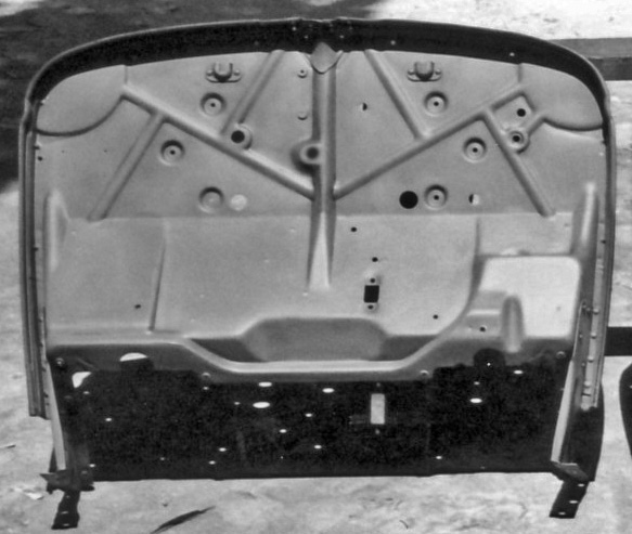

3w2 | -- 11-17-2017 @ 8:14 PM |
The Model B coil was mounted on the inside of the firewall in a horizontal position in the upper right side immediately to the right of center to two clinch (D) nuts attached to all '32 firewalls. The top of the coil faces the right side of the car. The two clinch nuts show up pretty clearly in the photo below.

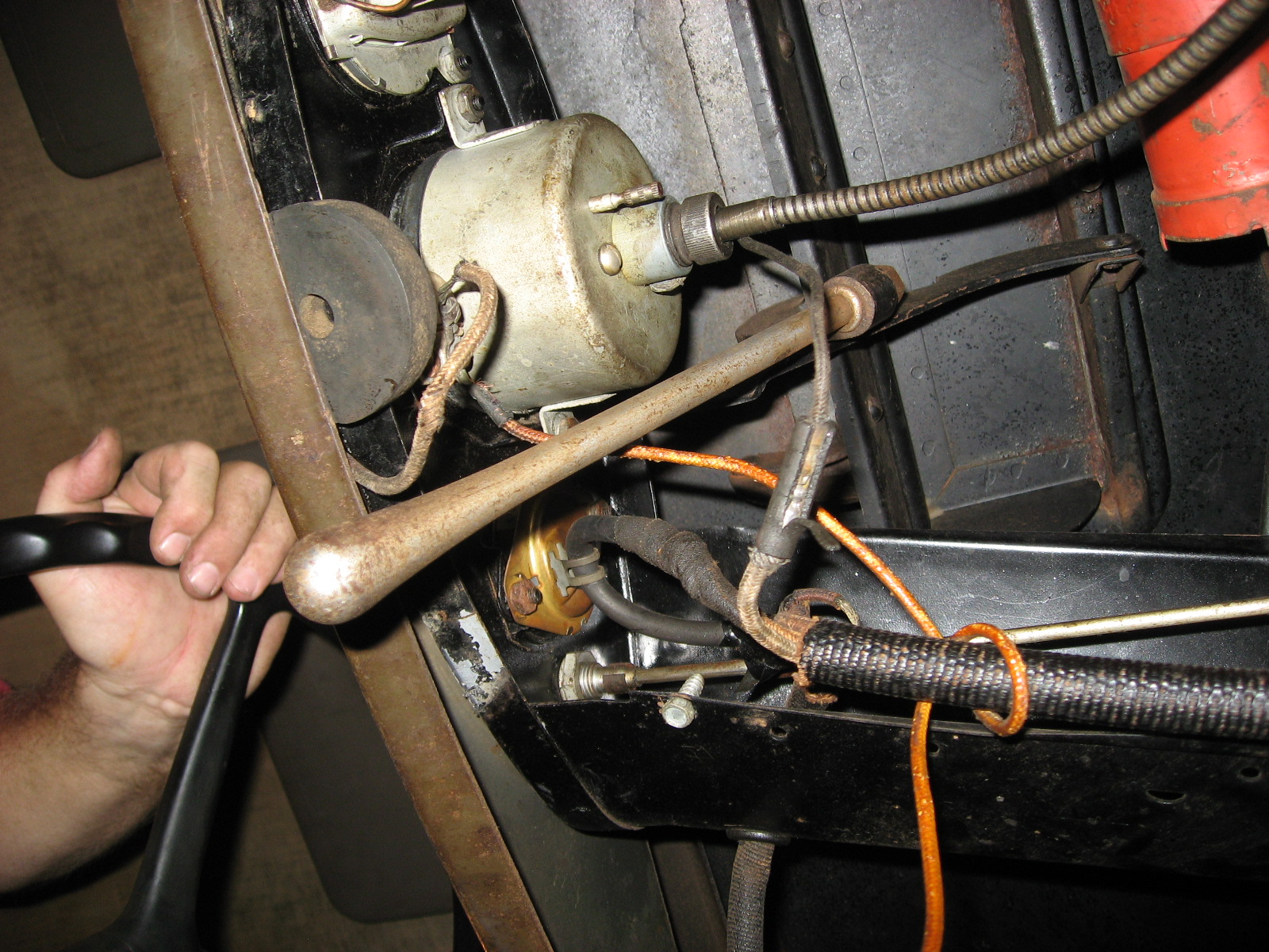

jim1932 | -- 11-18-2017 @ 5:08 AM |
This is where mine is. See the Red (non-stock Coil).
