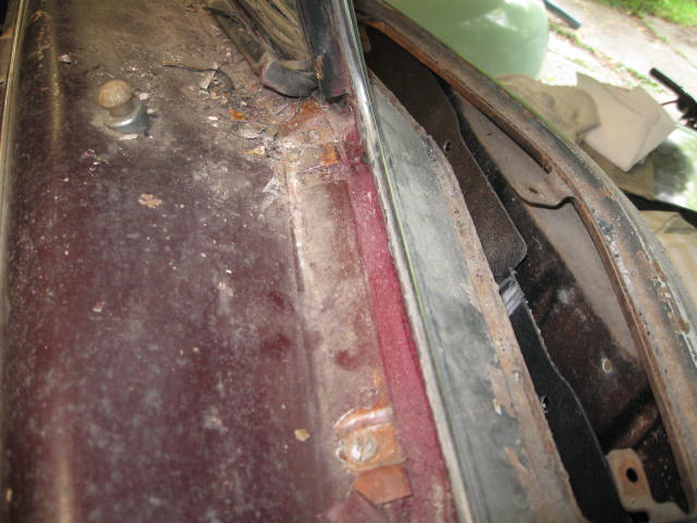

MICHV8 | -- 08-31-2016 @ 4:43 AM |
trjford8... My stainless appears to be pressure fitted onto the cowl lip. You can see at the top of the photo the driver rubber seal pulled back from the lip. The glass was original and only had flat rubber channel seal. It is very reluctant to move at all and I might opt to mask it for painting rather than risk damage try to pry it off the lip. Does this ring true for a 39?
