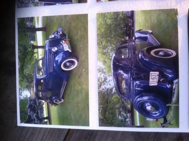

That is a nice 36. Most of us do not use the synthetic oil because the older cars cannot use the advantages of the oil, such as longer oil changes and flowing better in cold temperatures. It also seems to find places to leak from that regular oil doesn't. I would not extend the time between oil changes as the filters for the older cars are not as efficient as the ones for modern cars and the oil will be contaminated by the un-burned gas that will be dribbled into the crankcase by the carburetor. Other than that, I see no problem with using the synthetic oil. Tom
