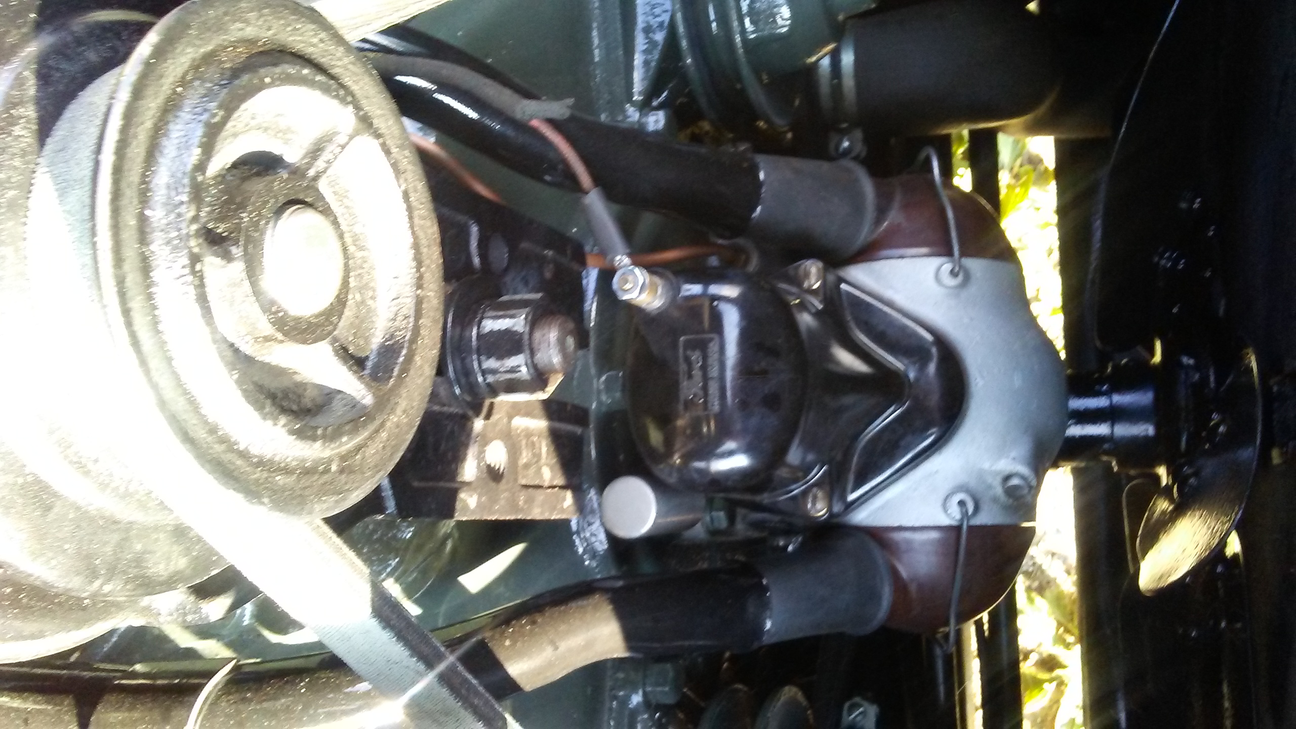

40headaches | -- 07-27-2016 @ 3:07 PM |
Distributor

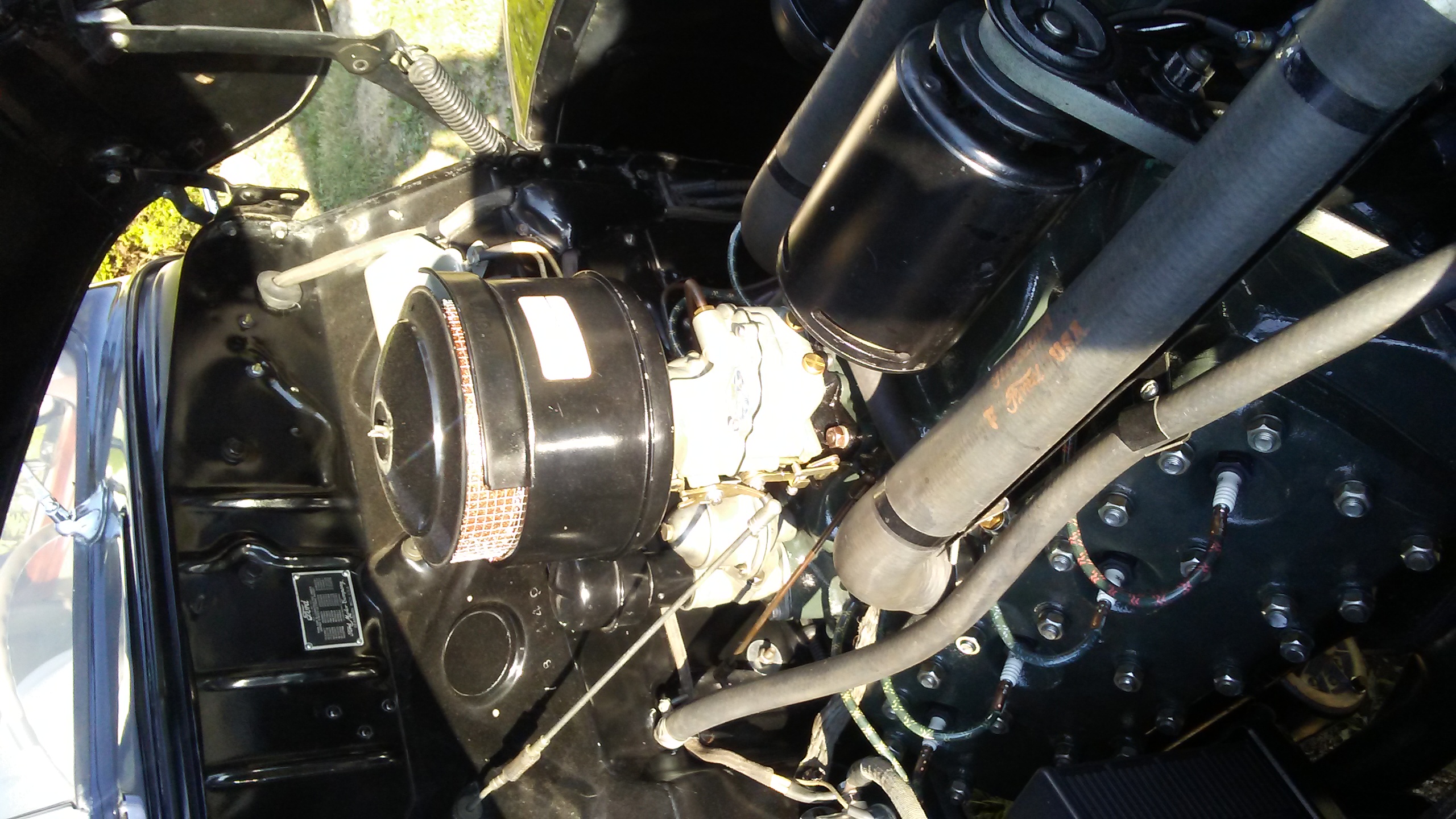

40headaches | -- 07-27-2016 @ 3:08 PM |
fuel and carb

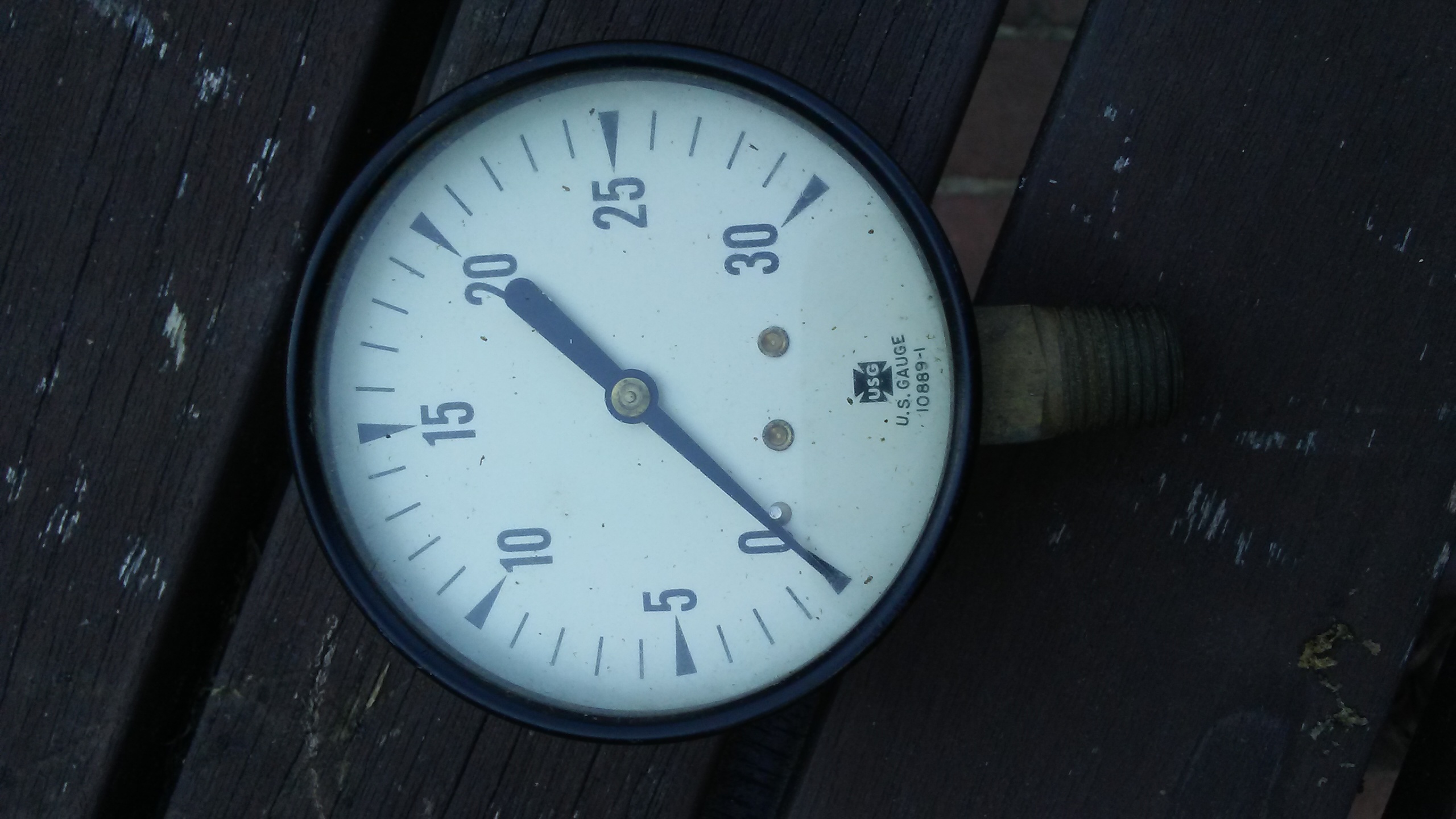

Can I use this gauge as a vac. gauge? can I hook it up where my windshield wipers go into the intake? Also they do not work at all. They did prior to rebuild. Might be helpful to know.

that looks like a pressure rather than a vacuum. Usually a vacuum guage will be marked as such on the face.

The gauge pictured can not be used to measure engine vacuum. Nearly all of the vacuum gauges also measure fuel pump pressure. They read vacuum in inches of mercury calibrated scale, the scale for fuel pump reassure is PSI. The wiper motor not running is most likely a second problem. Remove the wiper hose from the steel vacuum tube and connect the vacuum gauge to the engine. It does sound like a Carb problem. The 40, 85HP used the Ford 91-99 Carb. I have sent you a PM This message was edited by 40 Coupe on 7-27-16 @ 5:32 PM
