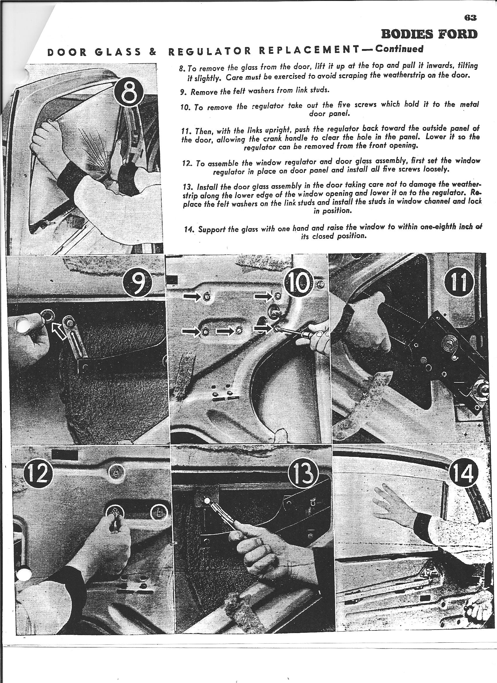

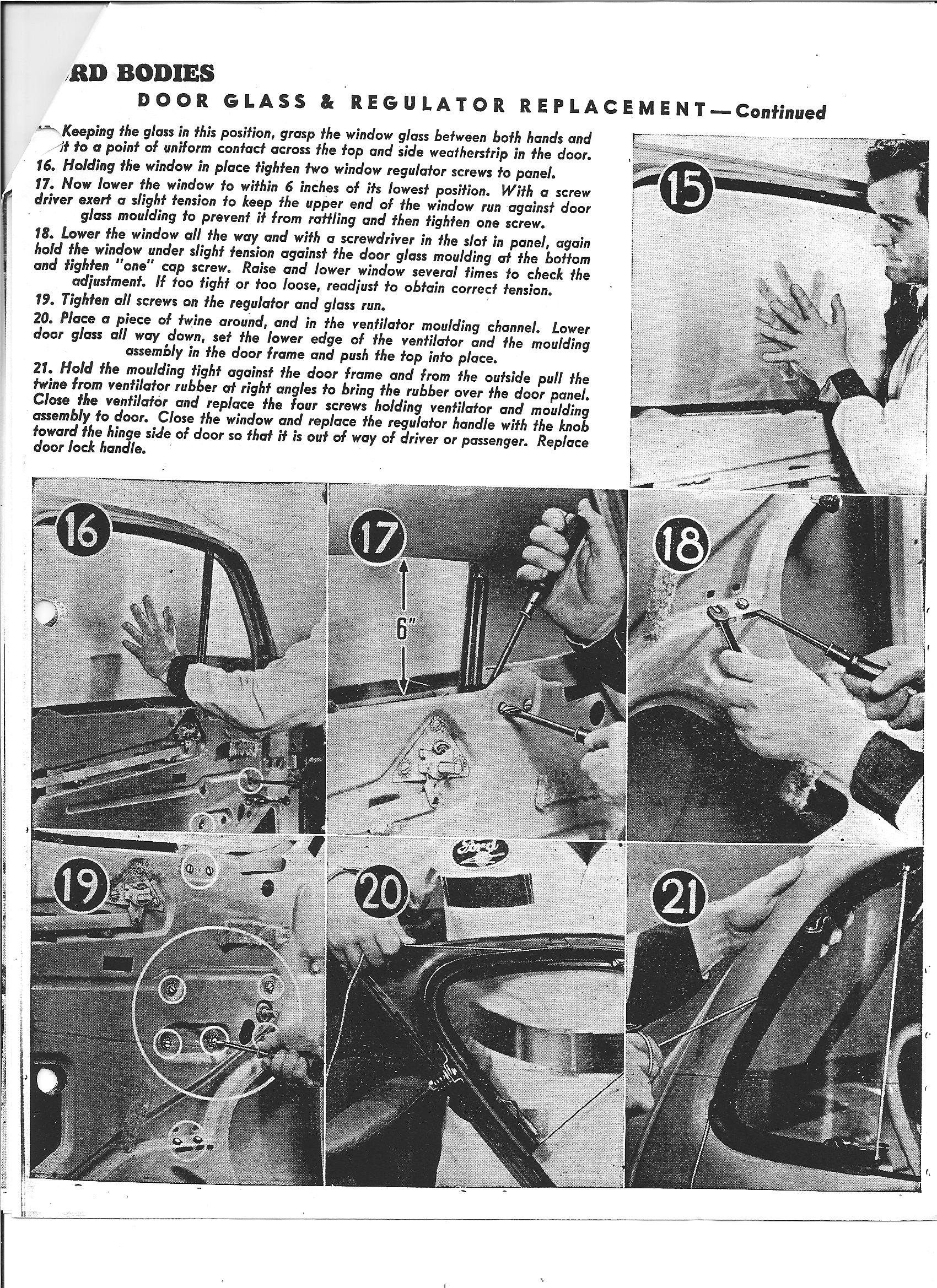

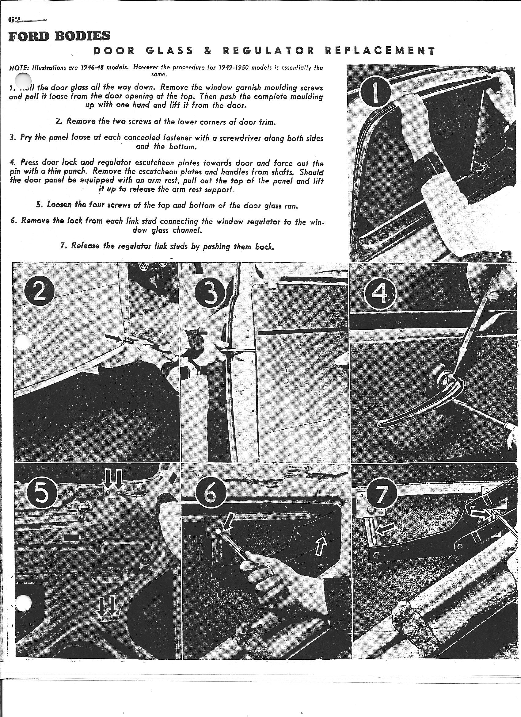

trjford8's instructions are simple. but if you want more detail, I attached a couple .pdf files. I've long since forgotten where I found them and who wrote them up. see my second post for the second half of the instructions.
fenbach | -- 04-25-2016 @ 5:07 PM |
part 2 and if that's not enough, I'll post 3 more files with pictures. This message was edited by fenbach on 4-25-16 @ 5:10 PM
fenbach | -- 04-25-2016 @ 5:11 PM |
page 1. again, no idea where this came from. This message was edited by fenbach on 4-25-16 @ 5:12 PM
fenbach | -- 04-25-2016 @ 5:12 PM |
page 2
fenbach | -- 04-25-2016 @ 5:13 PM |
page 3. that's all folks
