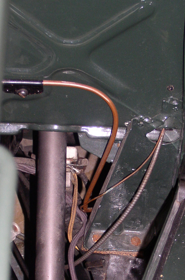

Old Henry | -- 07-18-2015 @ 6:49 PM |
The female end is the flared end. The male end has a tapered fitting that goes inside the flare.
Old Henry | -- 07-18-2015 @ 6:57 PM |
I guess "thread-wise" the flared end is the male end. Attached is a picture of the joint showing the flared end of the fuel line and the fitting on the flex hose that attaches to it.
