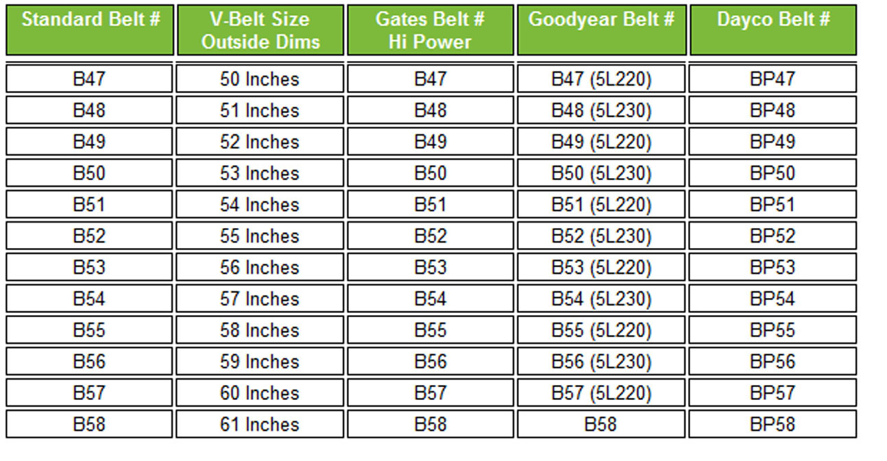

My '36 has a '37 motor w/'36 heads. What suze fanbekt should l get? I bought a new one but it was 52".l need a 57". Anyone know where Ican get a 57"? I know someone must carry them. Please, help. This message was edited by flatfoot on 10-2-13 @ 5:38 PM

I have a 36 Ford with a rebuilt 37 engine and 36 heads. I don't think there is any difference in the fan belts because you are still using the 36 water pumps and generator and crankshaft pulley. NAPA probably has the right belt. dicker Dick Kurtz
Don Rogers | -- 10-03-2013 @ 4:55 AM |
Heres a chart that might help you find the right belt. Make sure that you get a "B" belt for proper width.

Thank you so much. This is very helpful.
