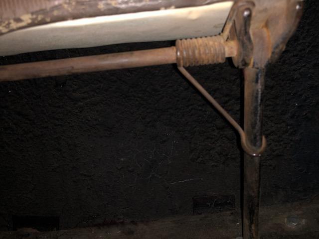

deuce_roadster | -- 03-29-2012 @ 1:43 PM |
Mrtexas--here is a picture of the spring you are looking for. It is about 18" long and 1" in diameter. I see over on FB you were given Carpenter's phone number, I hope he has one of those for you. Good luck!
