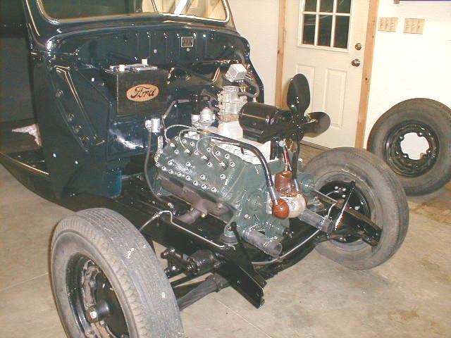

kubes40 | -- 09-27-2011 @ 8:29 AM |
DWJ39, Um, not quite DWJ... You are correct in that the script was on one side only. However, if you can't see the Ford script on your battery, then you have an incorrect battery. The 'standard' model had reverse posts vs. the deluxe model. The 1940 battery was larger than the '39. Nothing to do with the location of the script as that remained the same as '39. Antique Battery Company has sent me the incorrect batteries for the last two '39 standards I have restored. They are good about fixing their mistake at their cost but somehow manage to continue to make the same mistake. And, as long as we kind of strayed from the original post, the reproduction batteries although advertised to be identical to the authentic, are not. The sizes of the repops are off quite a bit. They also send the '39 batteries out with the incorrect cell caps. Again, they fix the problem but continue to make the same mistake... This message was edited by kubes40 on 9-27-11 @ 8:39 AM
kubes40 | -- 09-27-2011 @ 8:41 AM |
Here's a picture of a 39 standard...

dwj39 | -- 09-27-2011 @ 1:35 PM |
Mike: How do you explain the original Ford assembly line "body drop" photo on page 8-1 of the 38/39 book showing a 39 Deluxe with the battery facing toward the fender.

ford38v8 | -- 09-28-2011 @ 7:32 AM |
Antique Auto Battery has been sending out the wrong caps for many years. It's never been an issue to most unless working on a deadline, as they hav e al;ways been happy top send the right ones ...and don't bother to send back the wrong ones. It's just their policy to not get involved in anything but making batterys, and Dan, it is a very good battery, better than original. The Optima , of course, is superior in performance but not in the game in aesthetics. As for explaining the body drop picture, that's an easy one! This is a staged picture for publicity. Notice how it takes three assemblymen plus a foreman to drop the body? They wanted to make sure tat the oval/script was prominant for the picture. Alan
