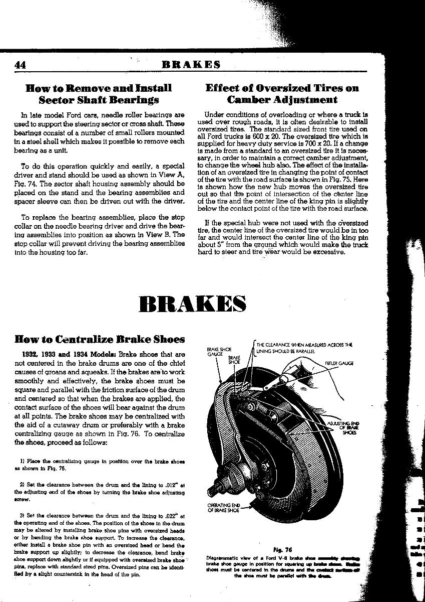

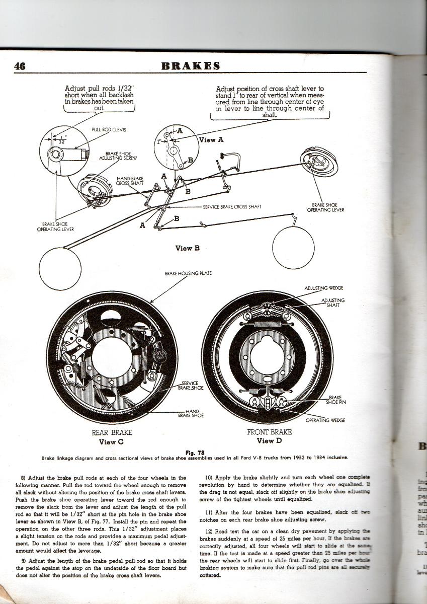

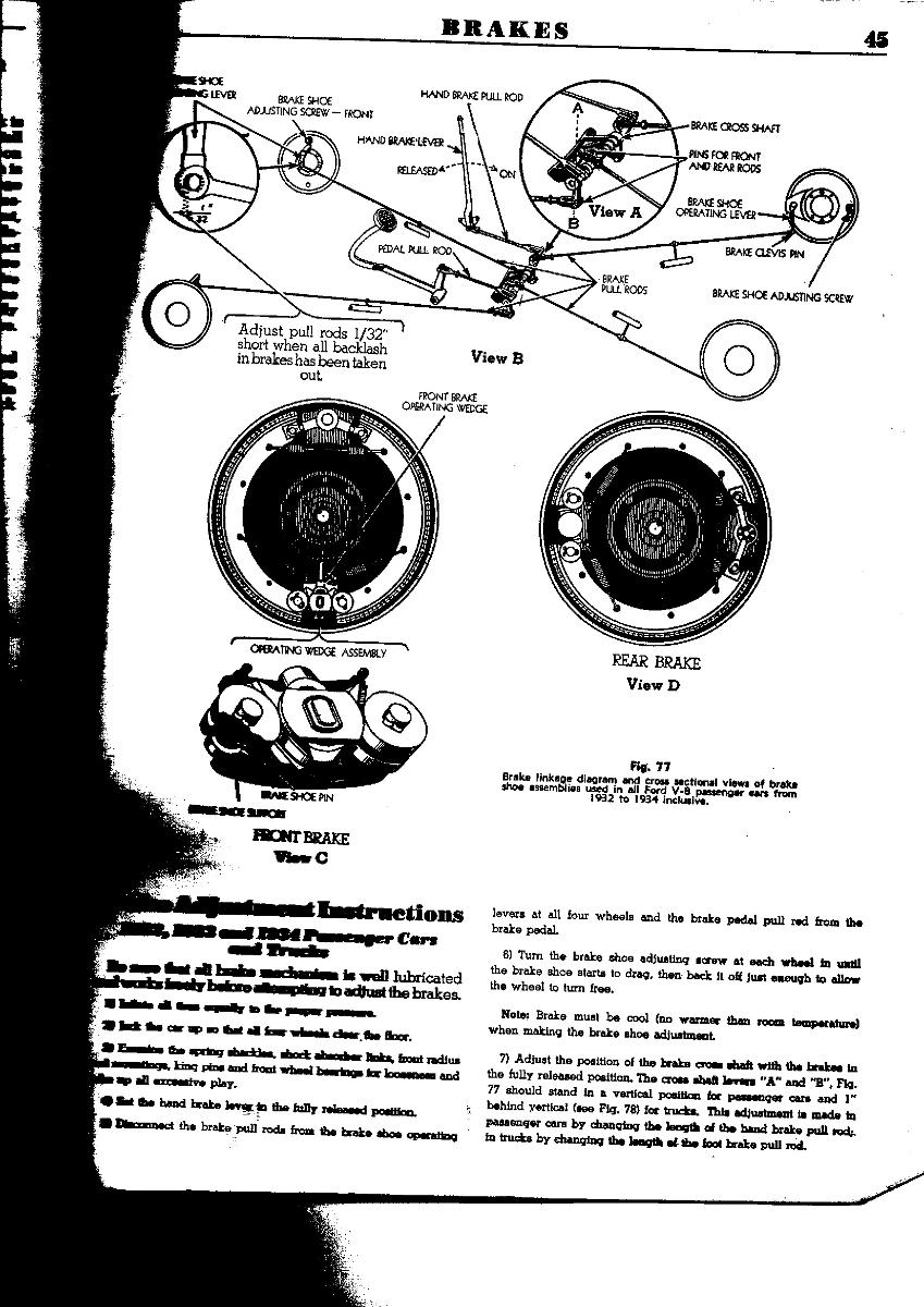

lawrie    -- 12-14-2024 @ 4:48 PM
  Hopefully these show up
these came from service manual reprint, V-13,a lot of good info for you 33 in it
Lawrie
