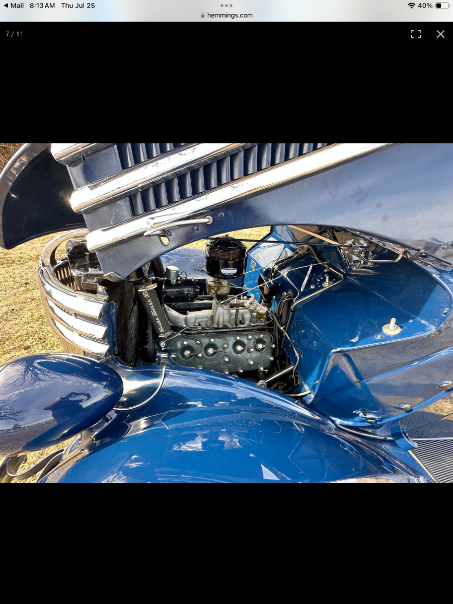

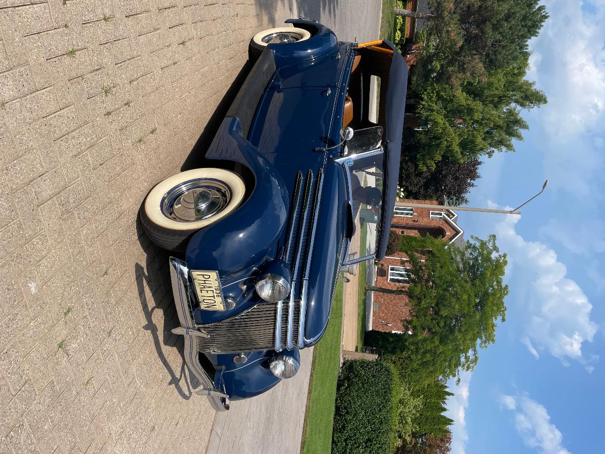

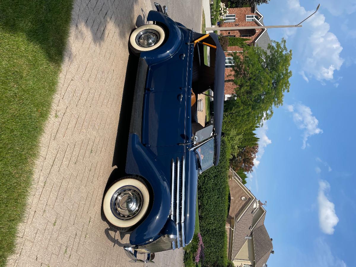

Just purchased a 36 with flat head, six volt, any thoughts Can you put another battery having two to help It was 100f when I picked up the car after driving 30 miles would not start Any help

Beautiful car. Step one, put your general location in your profile. Don't try the brute force solution of a second battery, find and fix the problem. Did the amp meter show a charge when driving the car? With the engine off and you turn on the headlights does the amp meter show a discharge? These cars were positive ground and sometimes people instal the battery backwards. When it didn't start, did the lights work? Was it completely dead? Are the battery cables heavy ones designed for 6 volts or the smaller cable designed for 12 volts? Charlie Stephens This message was edited by CharlieStephens on 8-1-24 @ 7:59 PM

Well, the first clue is that you state that it was 100 degrees when you picked up the car. It might be vapor lock. It sounds like you are new to flatheads and vapor lock is a common problem. Why would you go thru the expense and labor to install another battery, as others have said, cure the problem. Does the car have an electric fuel pump? Have you checked all the electrical's, especially the grounds? When was the last tune up, plugs, points, rotor, cap wires and condenser? How is the starter, was it rebuilt? Lot's of other things to check before you start adding more batteries. It look's like a very nice car, get it running right and enjoy it.
