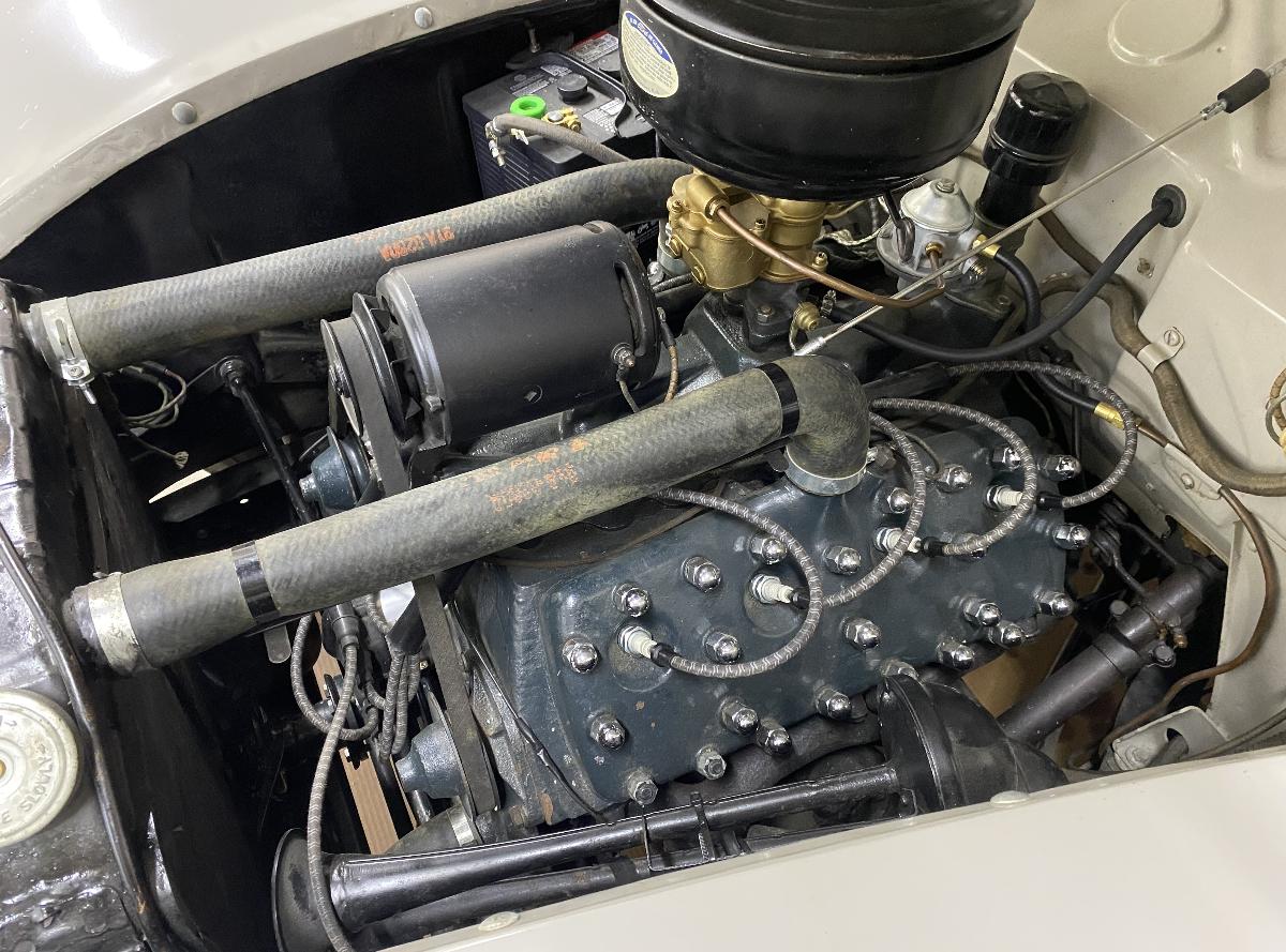

I would appreciate some recommendations on what type of motor oil is best for Flat heads: 10W-30 conventional, synthetic blend, full synthetic, oil with extra Zinc etc. I have a recently acquired 1940 Ford with a presumed rebuilt Flat Head (engine runs strong, no smoke). Intended use will be very occasional mostly shorter trips. (I use Molil 1 in everything else I own; would it be good in the 40?)
