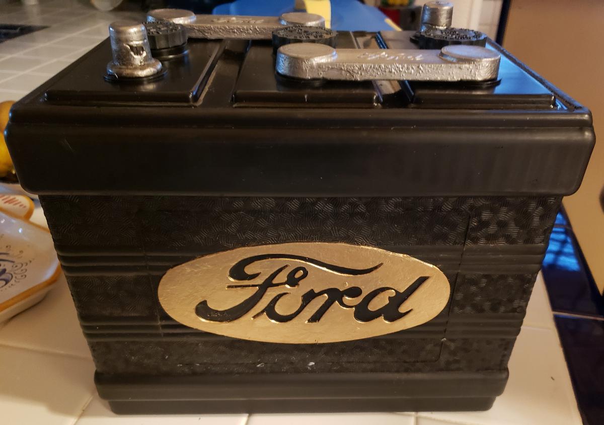

Purchased 1936 Cabriolet, and has a 8 volt battery, can I adjust the voltage regulator enough to charge 9.5 volts , or replace with the correct 6 volts?

You are better off with the intended 6 volts, in my opinion. Ken

If all your wiring is good and all the connections are clean and tight, especially the ground's, you should have no problem with 6 volts.

An eight-volt battery is installed by someone that either doesn't know how to repair their car properly or is simply attempting to fix the car cheap and quick. Please, rid yourself of that backyard band-aid "repair". Install a 6v battery and then go about figuring out why the last guy thought that 8v. was necessary. Nearly always, it comes down to a PROPERLY rebuilt starter, PROPER battery cables (no, you do not need extra ground cables), proper, IE paint and grease free areas of ground contact. One area often overlooked is the end of the starter and the adjacent area on the oil pan. Both of these surfaces were masked at the factory and as such were bare, providing a good grounding path. Another area? The back of the generator bracket and adjacent area on the valve chamber cover (aka intake manifold). One more thing to check... reproduction starter switches are nearly always very poor quality. You'd be wise to source a NOS button or a NORS button. The threaded stud on the dash panel (aka firewall) was also masked along with about a diameter of approximately .750" of the sheet metal. Why? Difficult to get a good ground through paint. Bottom line? All fairly easy and cheap things to fix correctly. Mike "Kube" Kubarth This message was edited by kubes40 on 5-30-24 @ 5:50 PM

I could not agree more about putting a 6 volt battery back into the car. I replaced my battery a few years ago with a repro stock battery. Although it looks like a flooded battery, there is an AGM battery inside.

A 1936 does not have a voltage regulator. It uses a cutout. Current is regulated by the adjustable brush position. As others have said, return to a 6v battery.
