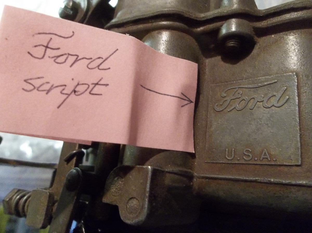

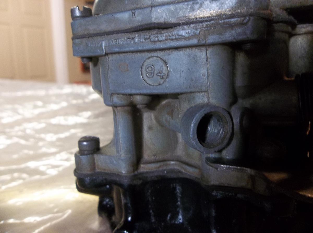

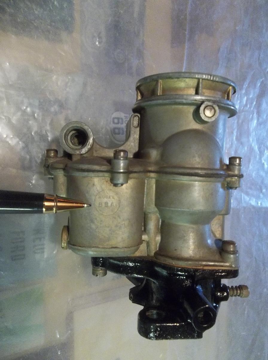

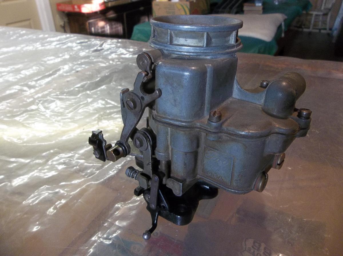

Grant | -- 05-16-2024 @ 5:02 AM |
I'm thinking that a stock factory original 1949 Ford carburetor should look like this one. Three photos .......

FordFreak | -- 05-16-2024 @ 5:37 AM |
Looks like the Holley 94 on my '52 F1. 1952 Ford F1 Pickup 1965 Falcon Sprint
Grant | -- 05-16-2024 @ 4:40 PM |
Bruce is right. Here's what the 8BA looks like:

42oink | -- 05-17-2024 @ 9:21 AM |
Gee guys, Thought I knew a little bit about these old Fords, and am still learning more. But I have no idea how a Ford script and #94 on the outside of a carburetor can affect the performance of an engine. Will be interested to learn. Thanks. 42OINK
