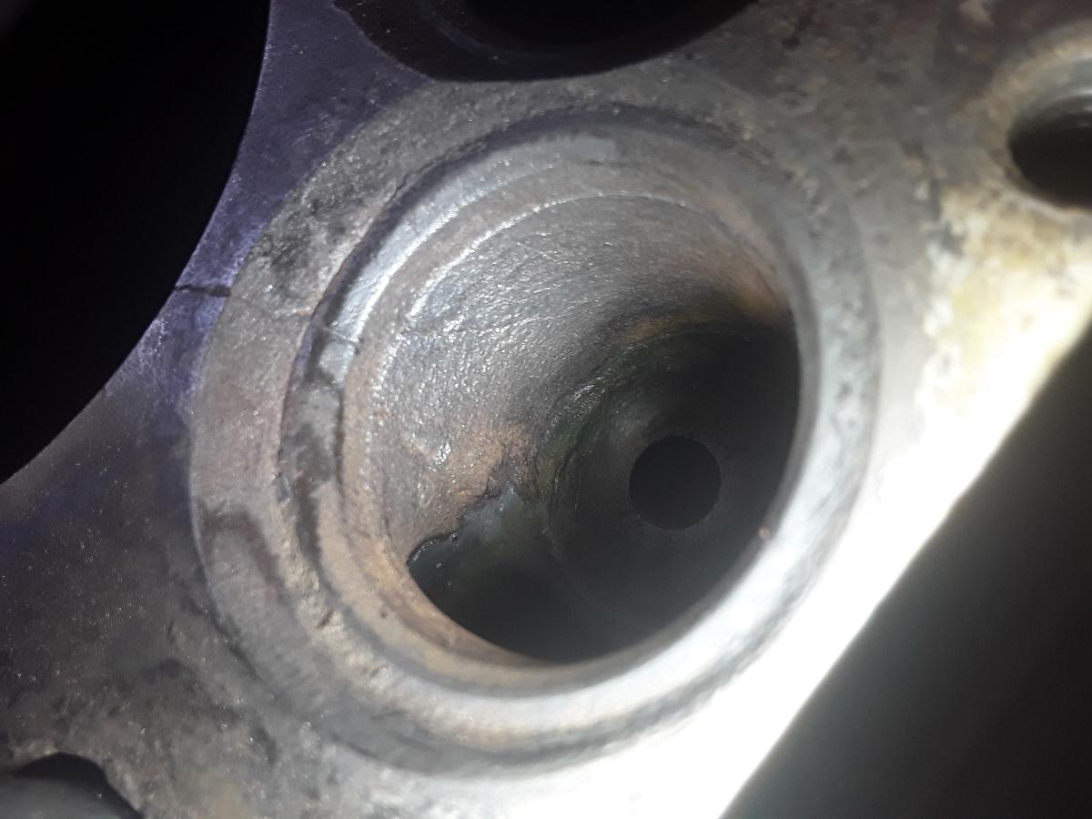

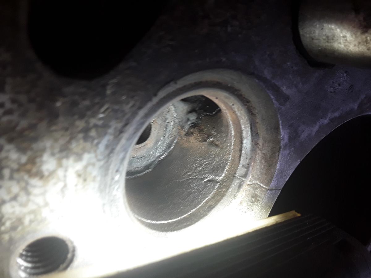

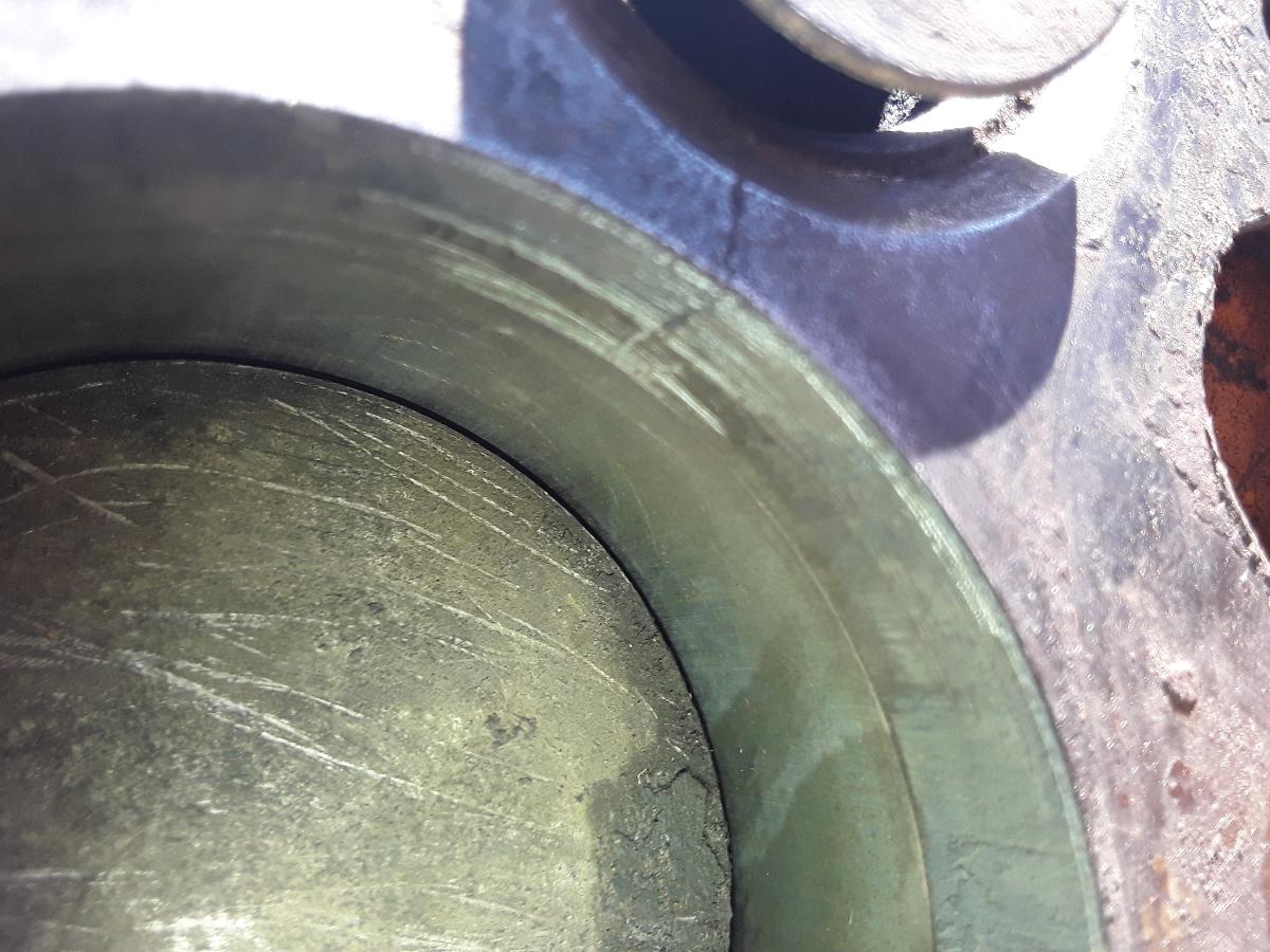

Is this the end of the road for this block..can the cylinder be sleeved? the crack progression into the exhaust port..can that be repaired?
pauls39coupe | -- 05-06-2024 @ 6:05 PM |
I would look for another block. Magnifluxing would show the true extent of the cracks, but pining them deep in the port is difficult.
square nutz | -- 05-08-2024 @ 7:43 AM |
very good - I was thinking same thing but dont know much adout these motors thanks for reply fortunnetly when I bought this car a 59ab was part of the deal
