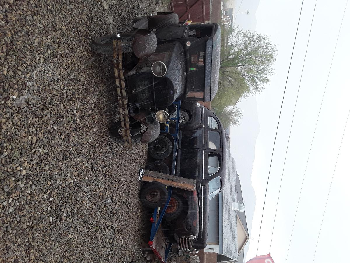

recently bought this 48 ford came with an 8ba and 3 speed floor shift im going to put a 59ab in and would like to find out if the trans will bolt up .. the only #s i can see look like a vin . *18-5541792* on the tower 817 ?9,8 or 3 case was green shift tower was red thanks for any help/replies
