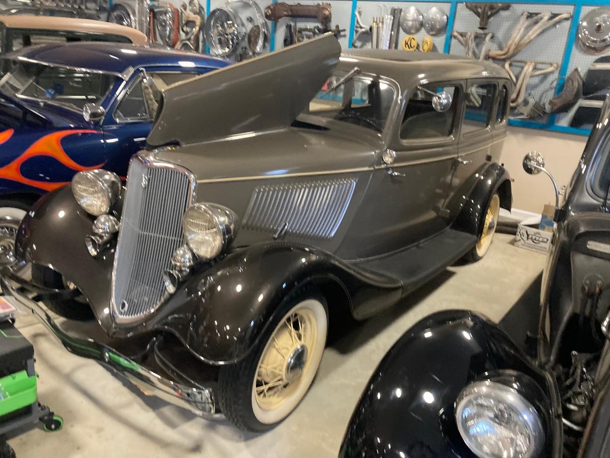

6 V electronic ignitionShould I replace the original points or should I go to electronic distributor or a Protonix unit thank you

dean333 | -- 04-06-2024 @ 8:40 AM |
Beautiful car as I said in your original post. If you ever want to sell, please let me know. Thanks. TIM CARLIG
