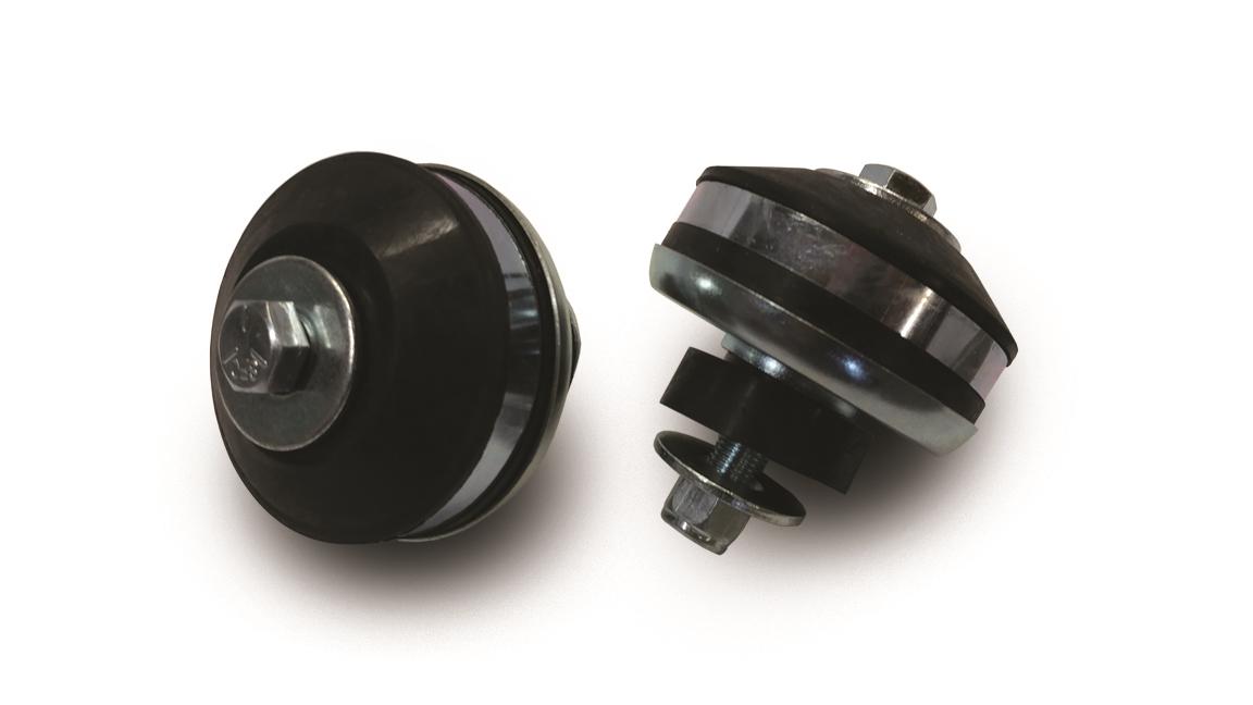

If Drake is out of them these are a good alternative. IMO https://redirect.viglink.com/?format=go&jsonp=vglnk_170648907470110&key=478da9cdb93cd3bfc02976eee2c19bf0&libId=lry7iqvo010025g6000ULp5pr1ni2&loc=https%3A%2F%2Fwww.fordbarn.com%2Fforum%2Fshowthread.php%3Ft%3D334843&ccpaConsent=1YNN&v=1&out=https%3A%2F%2Fwww.roadstersupply.com%2FFlathead-Style-Motor-Mount-Cushion-Kit-p%2Frsc-42804.htm&ref=https%3A%2F%2Fwww.fordbarn.com%2Fforum%2Fshowthread.php%3Fp%3D2287053&title=Clutch%20Chatter%20-%20The%20Ford%20Barn&txt=https%3A%2F%2Fwww.roadstersupply.com%2FFlath...%2Frsc-42804.htm ______________ No signature
