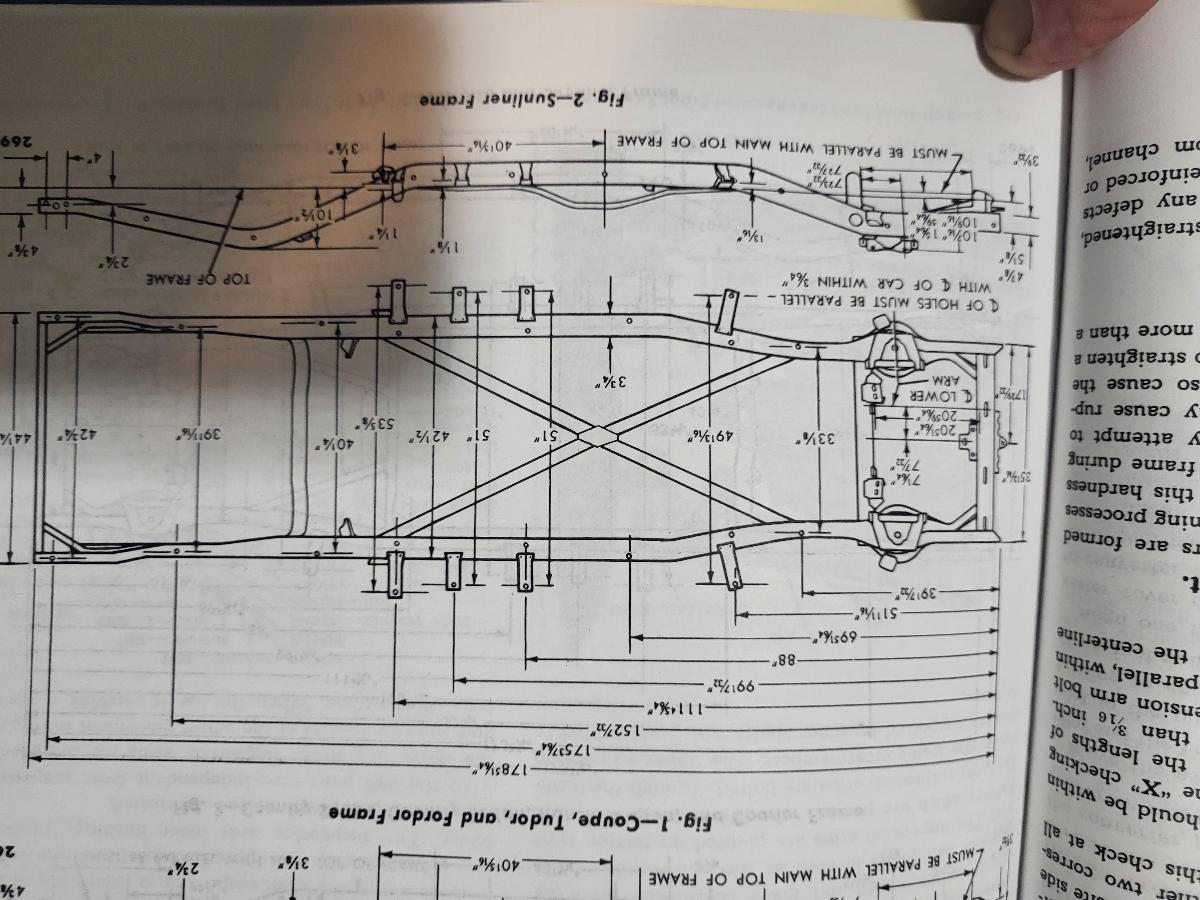

wlzemke | -- 01-18-2024 @ 6:38 PM |
Would it be possible to locate it on this drawing?
mikecnc | -- 01-19-2024 @ 8:15 AM |
On the top view drawing, bottom right corner, the diagonal brace between the front crossmember and the right side frame rail, it is stamped on the top of the brace. You will have to sand or scr*pe the paint or rust to find/see it. This is the number that your state DMV inspector will have to see in order for you to transfer the title to your name.

wlzemke | -- 01-19-2024 @ 6:14 PM |
I found it!! B3KC144888. He has the car trimmed up like a 52 but from the pictures i believe he started with a 53. Now that I have this is there a way to get the original data plate and a title? Thanks so much for you help!
