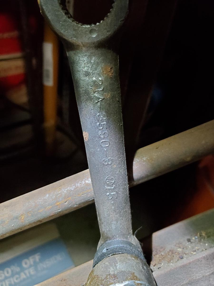

I changed the steering gear box in my 36 coupe in 1955 from the '36 to a '40, the 40 is the same as the 37 and later. I ended up having to change the frame mount, which was quite difficult cutting the rivets. I used grade 8 bolts to re-attach the mounting plate. For added safety I put a couple of spot welds, bracket to frame. I found that the '36, and later Pitman arm would not work, it hung down to low and looked dumb.. In time I found out the common way to correct the angle of the pitman arm was to heat and bend it... Did not like that idea. I kept looking for a pitman arm that would fit correctly, in time I found that the arm from a '47-48 Ford #21-A3590-3 015 fit perfectly with no alterations. Bill 36 5 win delx cpe This message was edited by wmsteed on 1-21-24 @ 9:48 AM
