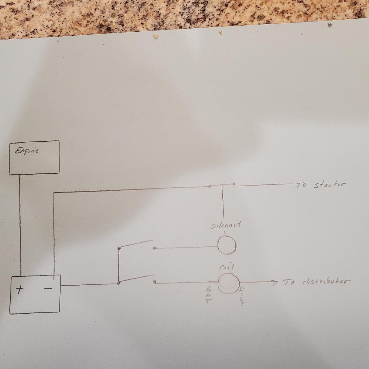

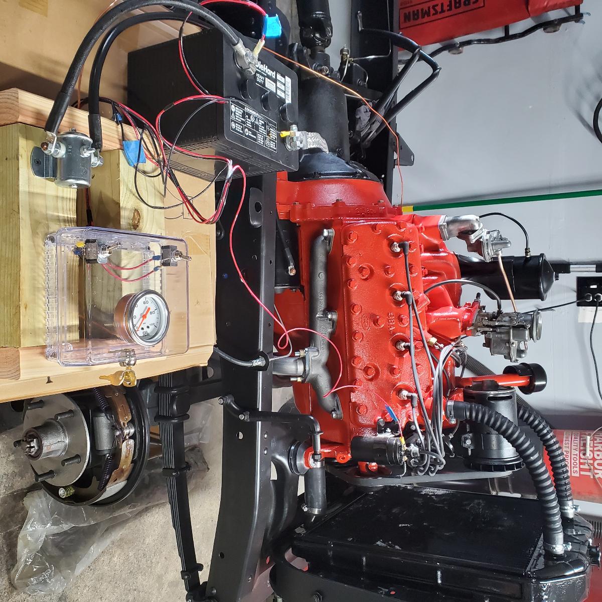

I'm attempting to start a newly rebuilt 8BA in my 51 F1 restoration project. I wired up the ignition and starter as per the diagram below. I do not have spark. I'm using a 6V battery using positive ground. I've changed the coil, distributor condenser 3x. I've flipped the wires on the coil as well. I'm holding an ignition wire from the coil to within 1/4" from ground. I'm getting no spark. The distributor itself has continuity to ground. I'm thinking of trying a 12v battery to the coil in case the coil is not a 12V coil. Any help would be appreciated. Thanks Raypratojr@gmail.com

Your wiring diagram looks correct to me. You can check if you have a 6 volt or 12 volt coil by using an ohm meter across the primary terminals on the coil. A 6 volt coil should measure about 1.5 ohm, which will allow 6 volts to push about 4 amps thru the coil and points. A 12 volt coil should measure about 3.0 ohm; 12 volts will also push about 4 amps.

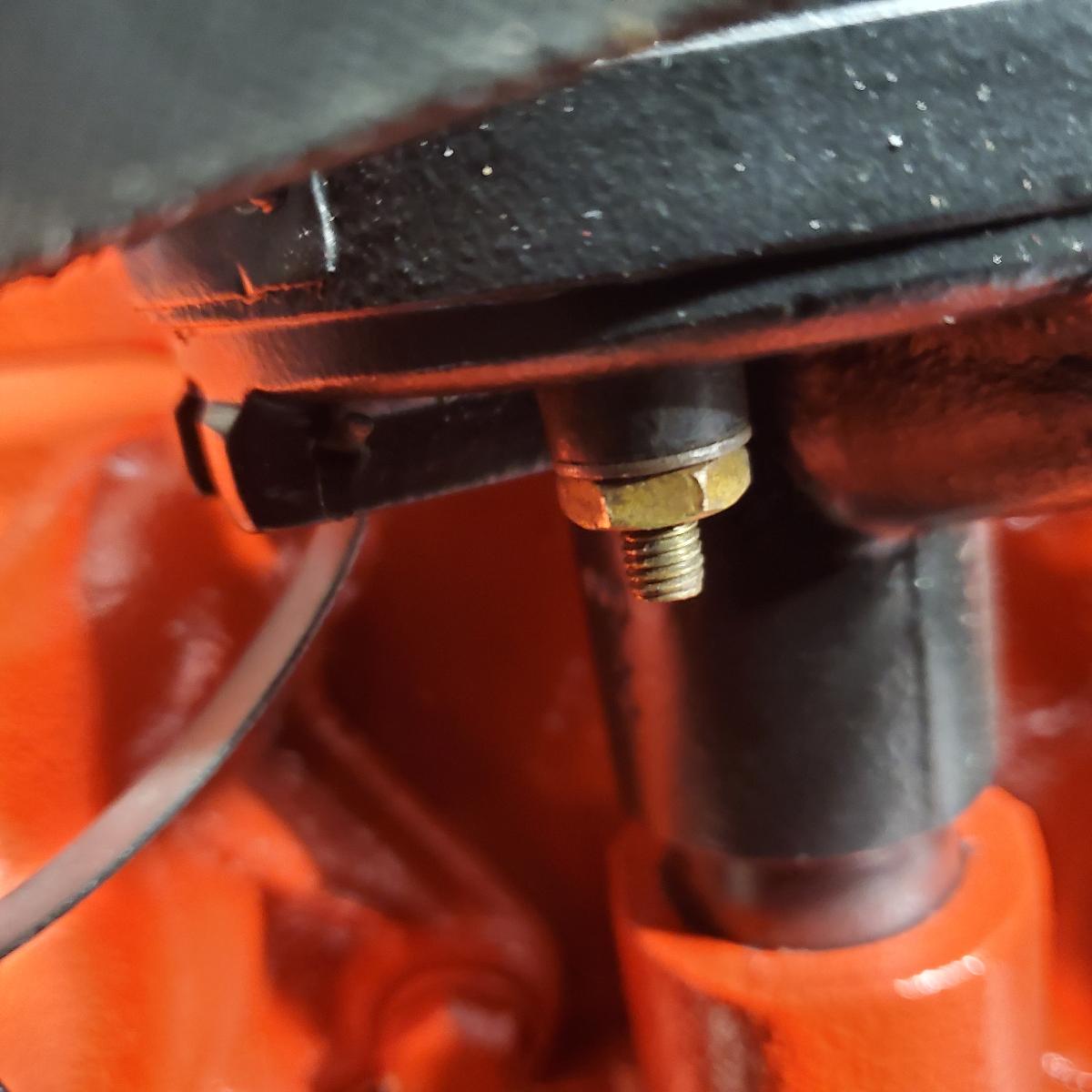

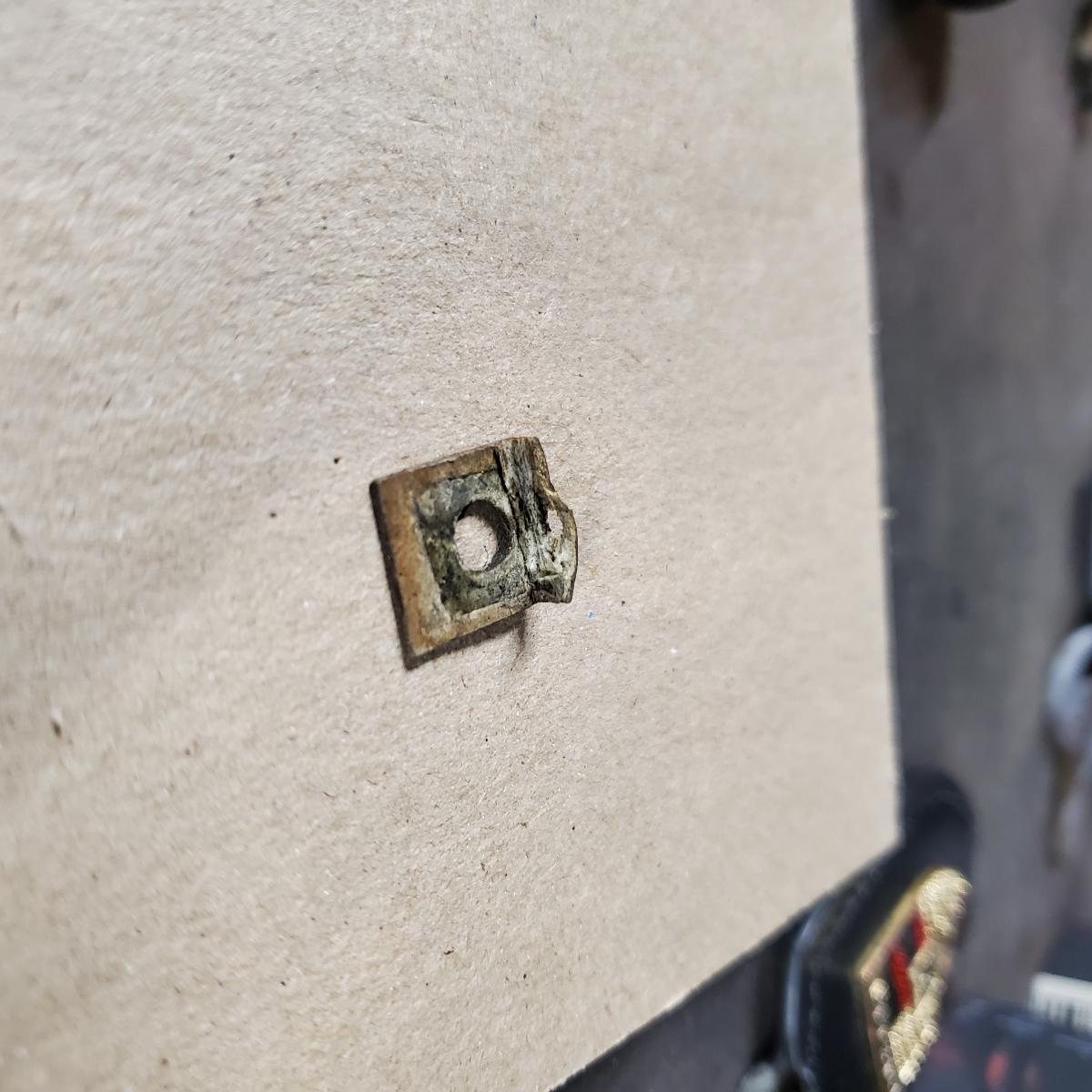

It wound up being the insulator under the stud to the coil wire had deteriorated. This caused thd points to be grounded constantly. Thanks
