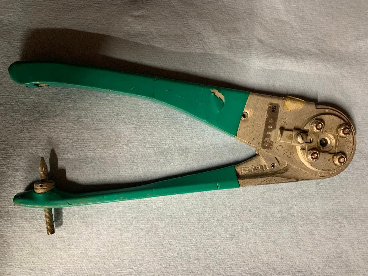

I have a proper “4 way “ crimping tool if you are interested. I do, however, always add a dab of solder at the tip and then round this with a small file or emery paper. Dielectric grease of course.
Jacques1960 | -- 10-27-2023 @ 1:32 PM |
Also, be sure you are buying bullet ends which actually CAN be crimped as some are much too hard.
Jacques1960 | -- 10-27-2023 @ 2:04 PM |
Buchanan 4 way crimping tool

Thank you for your quick response. I would be interested in. Using your set if you have no future plans for it. Let me know how much you want for it so I can make arrangements with you. In the meantime, from the responses I’ve received, I think I should brush up on my soldering skills. But so far, it’s a distant plan B.
