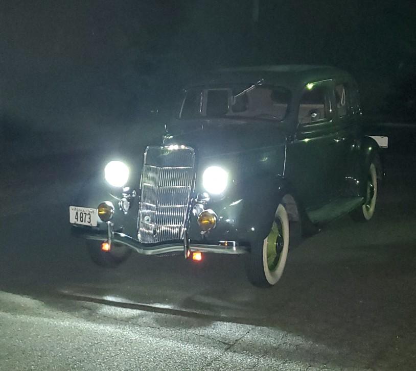

I just got them from LEDlight.com for my '35. This message was edited by ndnchf on 8-15-23 @ 10:15 AM

ndnchf - could you post a part no. Or a link. I can't find any replacement bulbs, much less 6 V on the website LEDlights.com Then, do the bulbs fit the original sockets? And what reflectors did you use? Thanks
ndnchf | -- 08-15-2023 @ 10:13 AM |

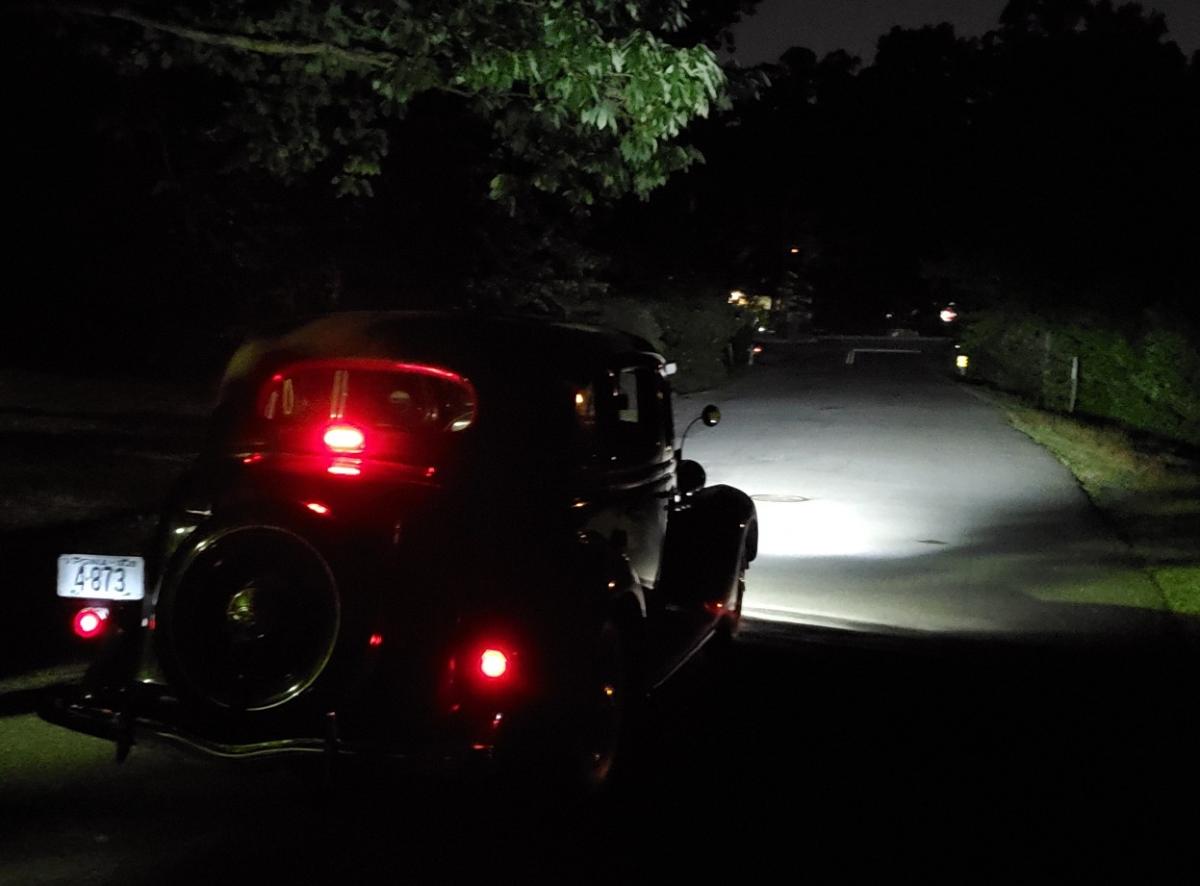

The head lights are part # 62528. The tail lights are part #95634, these have offset pins. The do make them for parallel pins too so check your tail lights before ordering. They all just replace the original bulb, no alterations needed. I just corrected the web site name. It is LEDlight.com This message was edited by ndnchf on 8-15-23 @ 10:18 AM

Tail lights: super white Head lights: white 6000K

fenbach | -- 08-30-2023 @ 7:56 PM |
And a curiouser experience. The dash lights [also LEDs] are on the same circuit as the taillights. But they light up when I step on the brake. Dim, but on.
JayChicago | -- 08-31-2023 @ 8:04 AM |
"The dash lights [also LEDs] are on the same circuit as the taillights. But they light up when I step on the brake." That is a symptom of poor grounding at a tail/stop light socket. When the brake light voltage can't get to ground easily, some voltage back-feeds through the taillight filament (or LED array) and into the taillight circuit. I have no explanation for the headlight issue. LED's are funny animals, above my knowledge. This message was edited by JayChicago on 8-31-23 @ 8:12 AM
