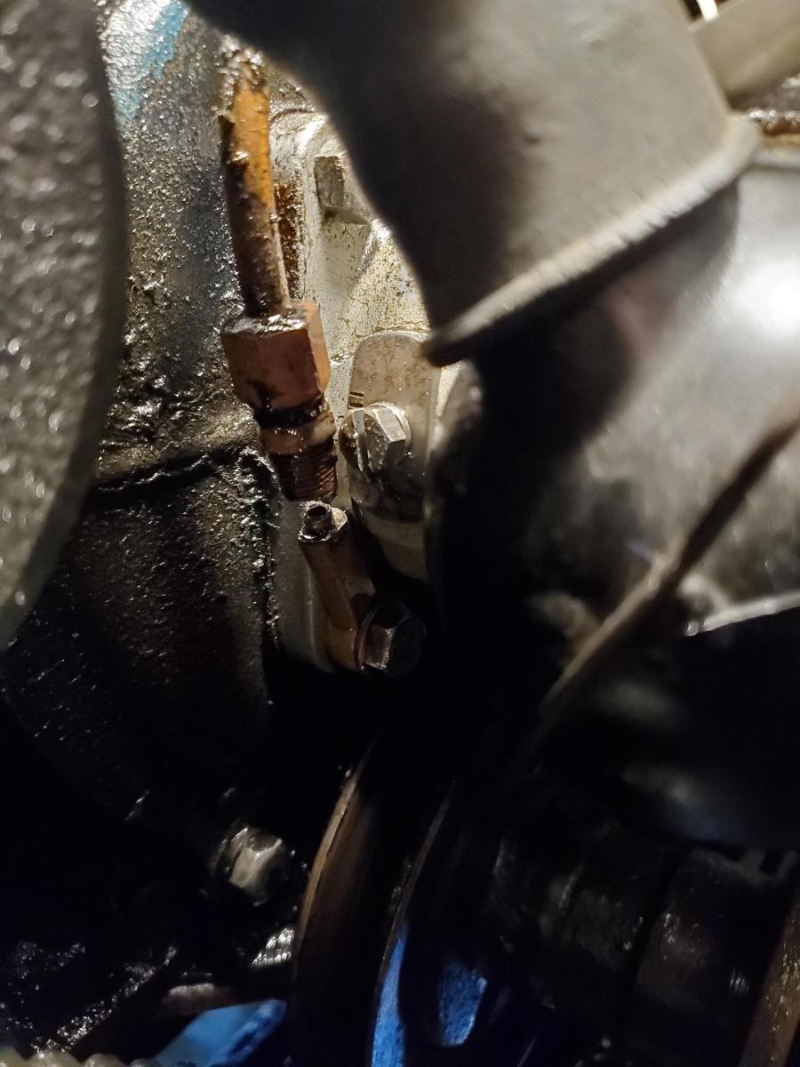

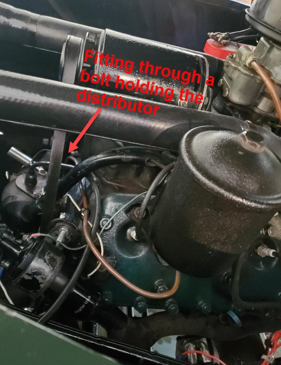

I blew the bypass oil filter line returning to the flathead v8 on my 1941 Ford Super Deluxe. Upon closer inspection I discovered the fitting that failed is designed to flow through a bolt that attaches the distributor (see images). Has anyone seen this type of setup before or is it a 1-off retrofit? Next, I'm trying to determine how to proceed. I'm wondering if there is somewhere I can find a replacement fitting or if I should braise it together or do something else. Looking for some thoughts.

I have a similar banjo fitting for the oil return line at one of the distributor mounting bolts on my '40 (not sure where this one came from-it has been too long). We couldn't find the hollow bolt for it at the time we installed the oil filter back in the late 1970's (my father drilled out a bolt at the time).

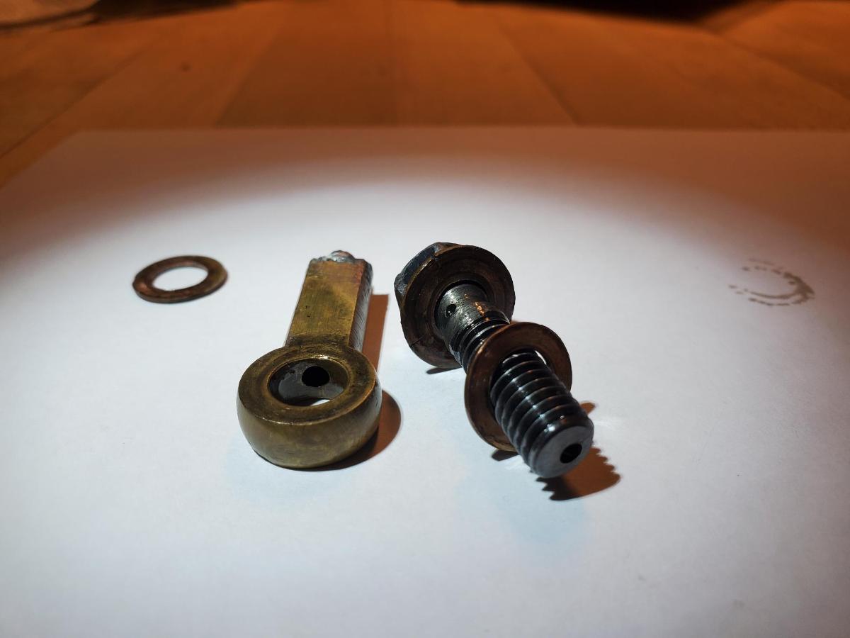

Here are the original type fitting used in 1940. You fitting was re-engineered to use copper tubing. The original fitting would be difficult to modify like that, but there are banjo fittings with bolts available. I would Google "SAE 1/2" banjo fitting" to limit the number of metric ones. Tom
