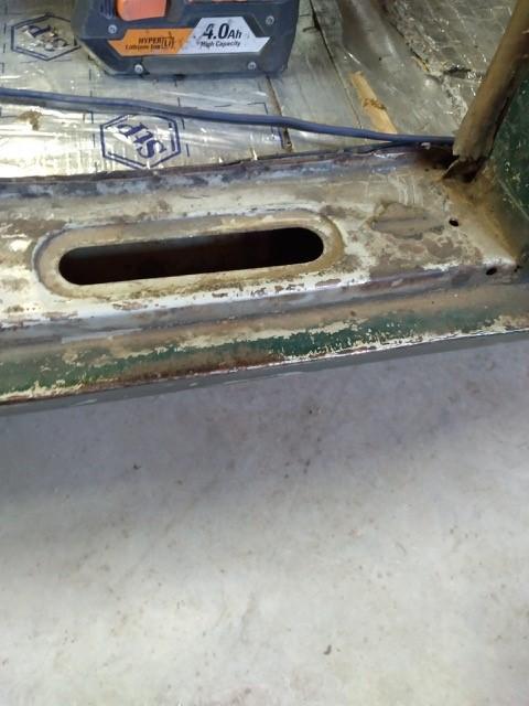

how do i know if my woody is a early or late build? I am trying to find the correct sill plates,tx. This message was edited by nipomo on 6-28-23 @ 3:49 PM

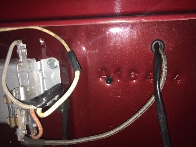

Your cowl number will help you identify it. It's the number on the cowl that starts with A Loren Sorensen's Wonderful Woodies book has all the Station Wagon numbers. Bad news is that I am currently 1300 miles away from it. But find your number and that will help you identify.

thx. where is that # located ?
Dan Duszkiewicz | -- 06-29-2023 @ 8:37 AM |
Underhood drivers side of vehicle. Under pinch weld for firewall to cowl between the OD solenoid (if equipped) and the main wire harness grommet (to passenger compartment). I have easy access to the book to get the date.

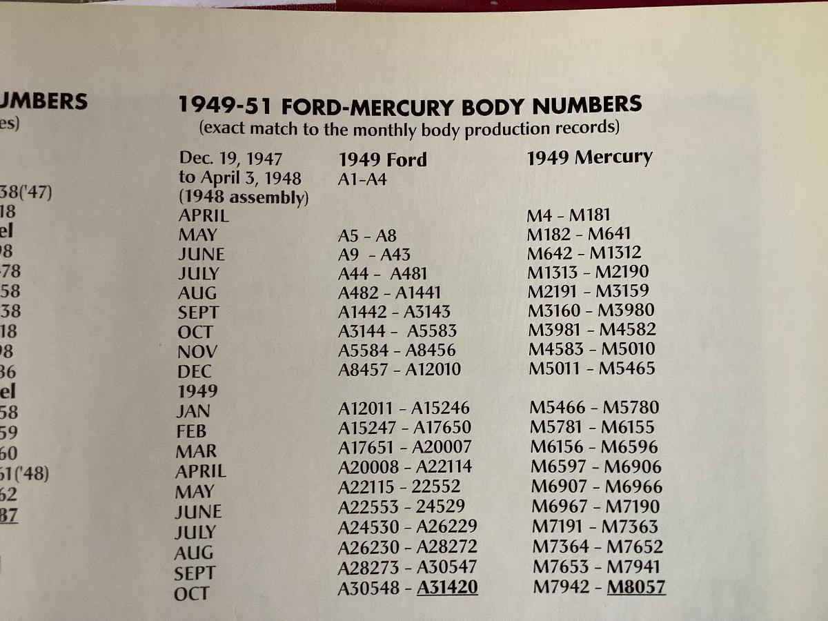

Dan Duszkiewicz | -- 06-29-2023 @ 9:47 AM |
Attached are the body numbers and dates.

It is NOT the data plate. Look at the picture again -- it is STAMPED into the cowl and starts with A xxxx it is not a plate. That is your VIN and will not have the A number on it. This message was edited by nelsb01 on 6-29-23 @ 4:41 PM

I looked on cowell and no stamped letters or numbers where you described. i think maybe some time prior it was bondo and painted any more locations ?
nelsb01 | -- 06-30-2023 @ 6:37 AM |
There was only one place for the body stamping A number. You may try and see if you can see it by looking under the dash area -- it of course would be in reverse. As far as I know, every body (at least 1949-1951) that was created at Iron Mountain had a body number stamped on the cowl, below the pinch weld. You are probably correct in your assumption that it was bondo'd over.
