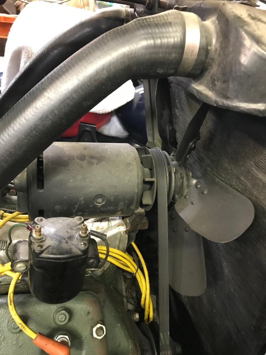

Anyone using one of these alternators? I'm thinking of finally converting from 6 volt pos ground to 12 volt. Still have a working original radio was trying not to eliminate. Pros and cons on pos or neg ground? The fan on my car is bolted directly to the generator, I don't see this configuration on any of the conversion units. Thanks

Really trying to avoid putting a GM alternator on the flathead I'm sure it would work, but....... I see this Powergen unit available 6 volt pos ground Front mount looks similar to what's on my 59 AB except the fan does not mount to he unit. I haven't disassembled my generator so I'm wondering if anyone knows if I can take the pulley assembly off my generator and put it on the Powergen.. Would the pulley line up with water pumps etc? Powergen couldn't answer

Just removed the fan leaving the generator still installed. The generator shaft is independent of the fan. you could run the engine without the fan and generator would still function. The 1/4 -20 bolts holding the fan to the pulley are only 1/2 inch long and have a lock washer so not much thread is holding it on.. doubt this is right, If the fan came off, some expensive parts would be toast. An electric fan would work, but how many amps is a 6 volt fan? I have a feeling the PowerGen uses a Mitsubishi or Denso alternator so the shaft is probably metric. Might be able to do something with the pulley carcrazy mentioned but it's probably not metric as well. Nothing is easy.

The reason you don't find alternators that accept the pulley mounted fan is that the front bearing in the alternator isn't heavy enough for the load of the fan. Someone may have solved the problem but I haven't heard about it. I hate the look of an alternator on an old flathead unless it has been reworked to fit in a generator housing. I would look for a 2 brush generator with a front mounted fan and have it converted to 12 volts, an easy job for someone that knows what they are doing. These generators will be hard to find, keep looking, calling, and posting ads. It has been several years but I think they were for '39 standard among others. I would go 12 volts negative ground (not positive) since that is what modern cars use and you can therefore use modern accessories. Other topic, paint the inside of your tail lights white or line them with tinfoil. Charlie Stephens This message was edited by CharlieStephens on 6-2-23 @ 10:00 AM

Just dropped off my generator at E J Whitney. Tom is the contact guy there, super knowledgeable and just a nice guy to deal with. He had several examples of his gen/alt conversions including several with the fan mounted on the pulley like mine. He said he could get the conversion done fast. Really excited to getting this installed.
