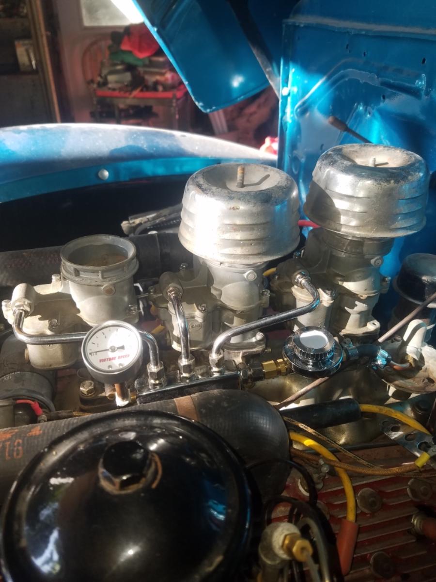

what type of fuel pump? these carbs don't like fuel pressure over 2.5 pounds. My 3x2 41 Ford has this system
rustedorrotting | -- 05-20-2023 @ 12:01 PM |
I also rebuild 94 and 48 and 97 carbs
