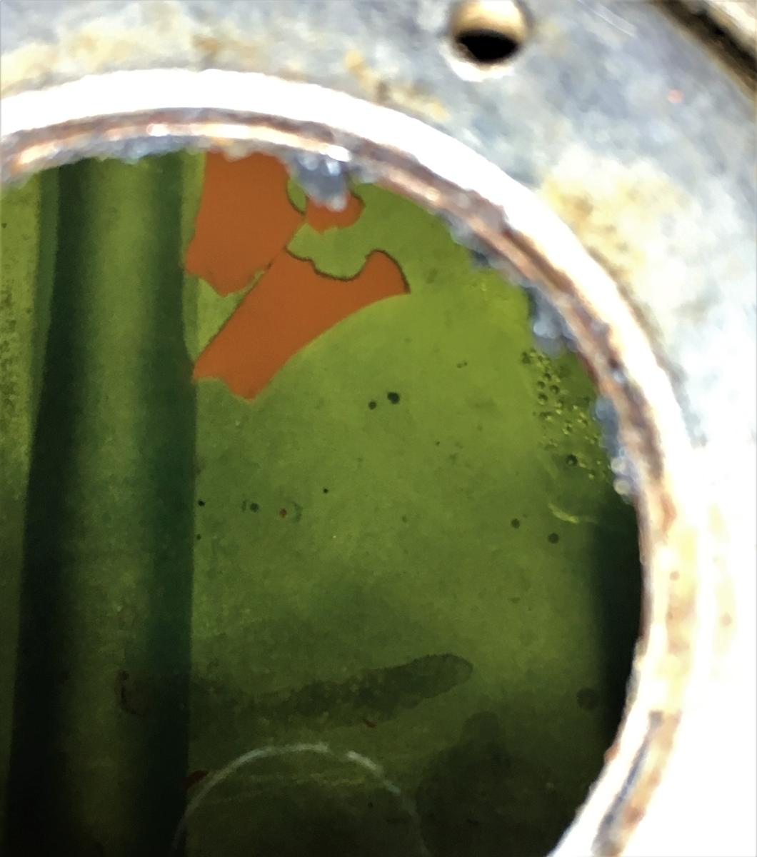

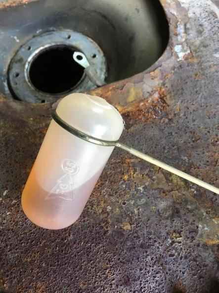

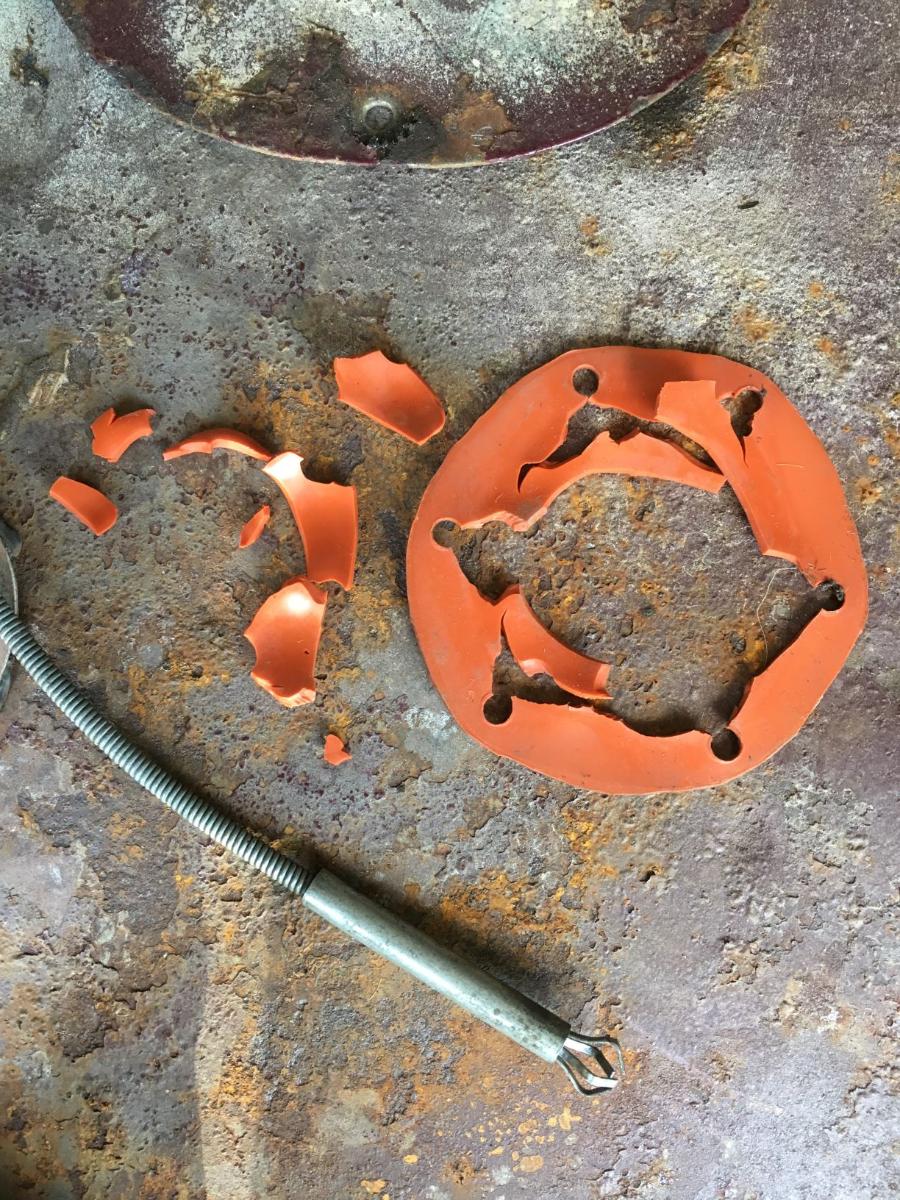

51woodie | -- 04-17-2023 @ 5:35 AM |
TomO gave a good suggestion about checking inside the fuel tank. A previous owner of my '46 Coupe used red rubber gasket material for the fuel sender. The gasket was poorly shaped, and the excess that was exposed to gasoline inside the tank opening broke away, and pieces ended up in the bottom of the tank. I found this out when I removed the fuel sender, to check the float for leakage. I was lucky that no pieces had plugged the fuel intake pipe in the tank. I have no idea how fuel got into the aftermarket float, but that was the issue with the fuel gauge reading incorrectly.
