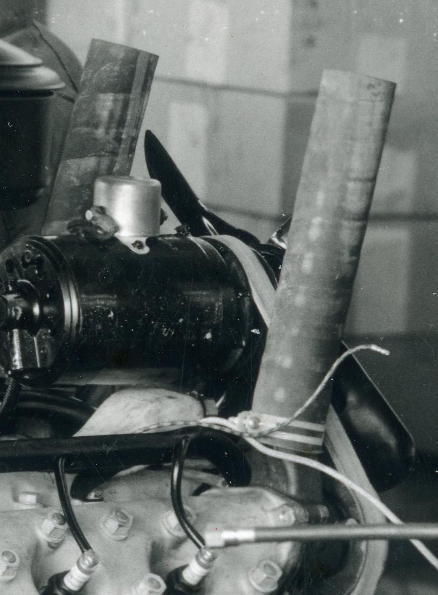

Don Rogers | -- 04-14-2023 @ 4:53 PM |
Here is an original factory photo of the Ford engine assembly line showing the upper radiator hoses. A stripe is visible on one of the hoses. No particular orientation can be seen here. LOL...make sure to scuff up your hoses as seen in the photo...LOL
