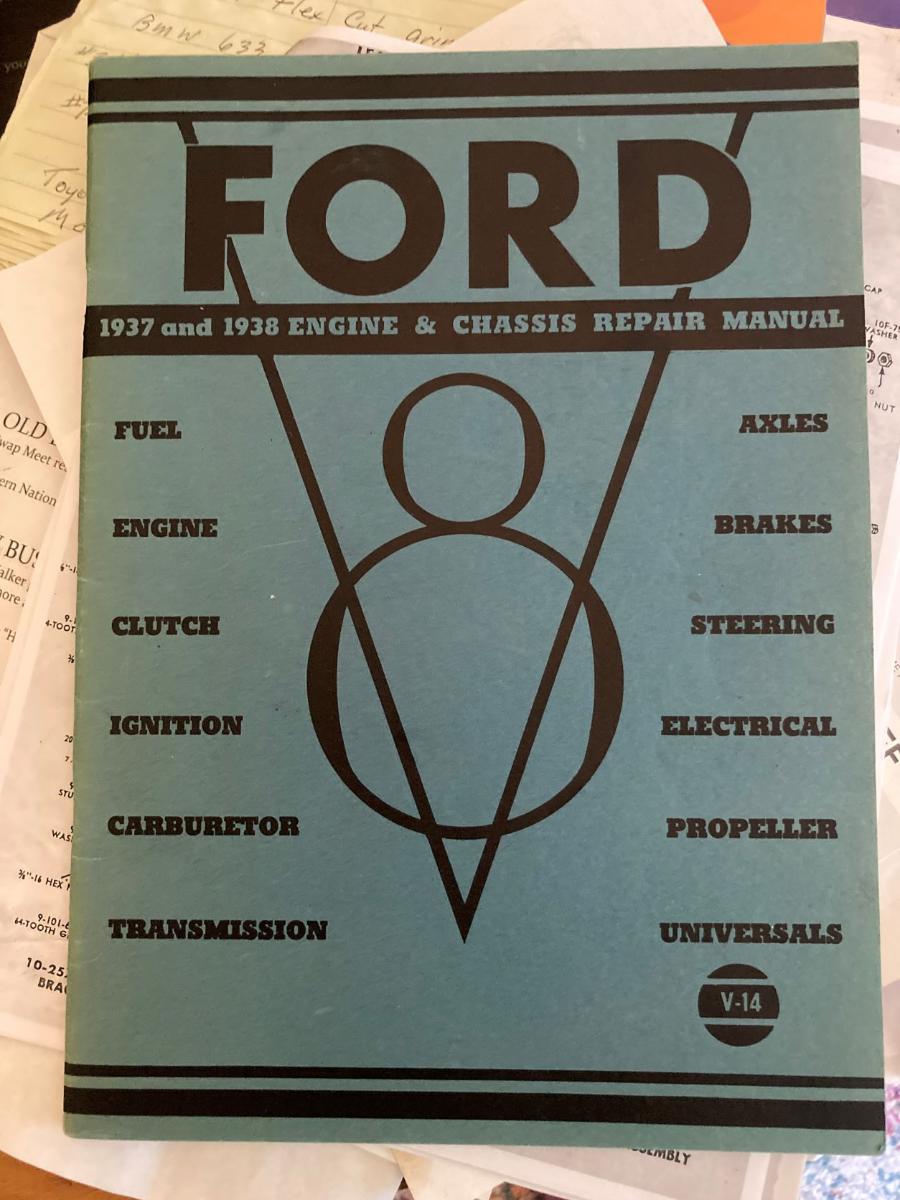

Welcome Liz, I also have a 1937 Ford coupe project. I like the reprint of the Ford Chassis Repair Manual, publication V-14. For instance, it tells you how to adjust the cable brakes, if your car still has them. You should be able to find it at many of the Early Ford parts vendors. One thing that is different on the old Fords from later model cars is the number of different types of lubricants used. There are many grease fittings on the early Ford chassis, not all of them take common multipurpose grease, particularly the front and rear leaf springs.
