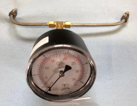

51woodie | -- 03-03-2023 @ 3:55 AM |
I have a fuel pressure test gauge kit ($25) that connects to the outlet of the fuel pump, but I wanted to know what the pressure was when the engine was running. I bought a good quality 0-5 psi pressure gauge, and teed it into a spare pump to carb fuel line that I have. Cost me a few dollars more to test the pressure this way, but I just had to know what the "running " pressure was. The answer...... about 1/2 psi, but I believe that is likely attributed to the difference in the accuracy of the two gauges.
