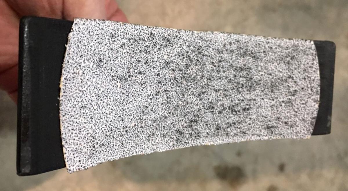

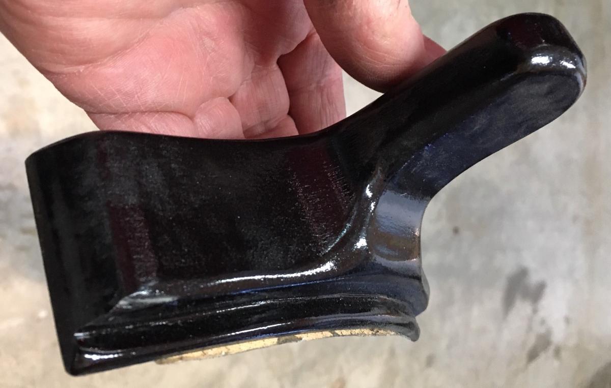

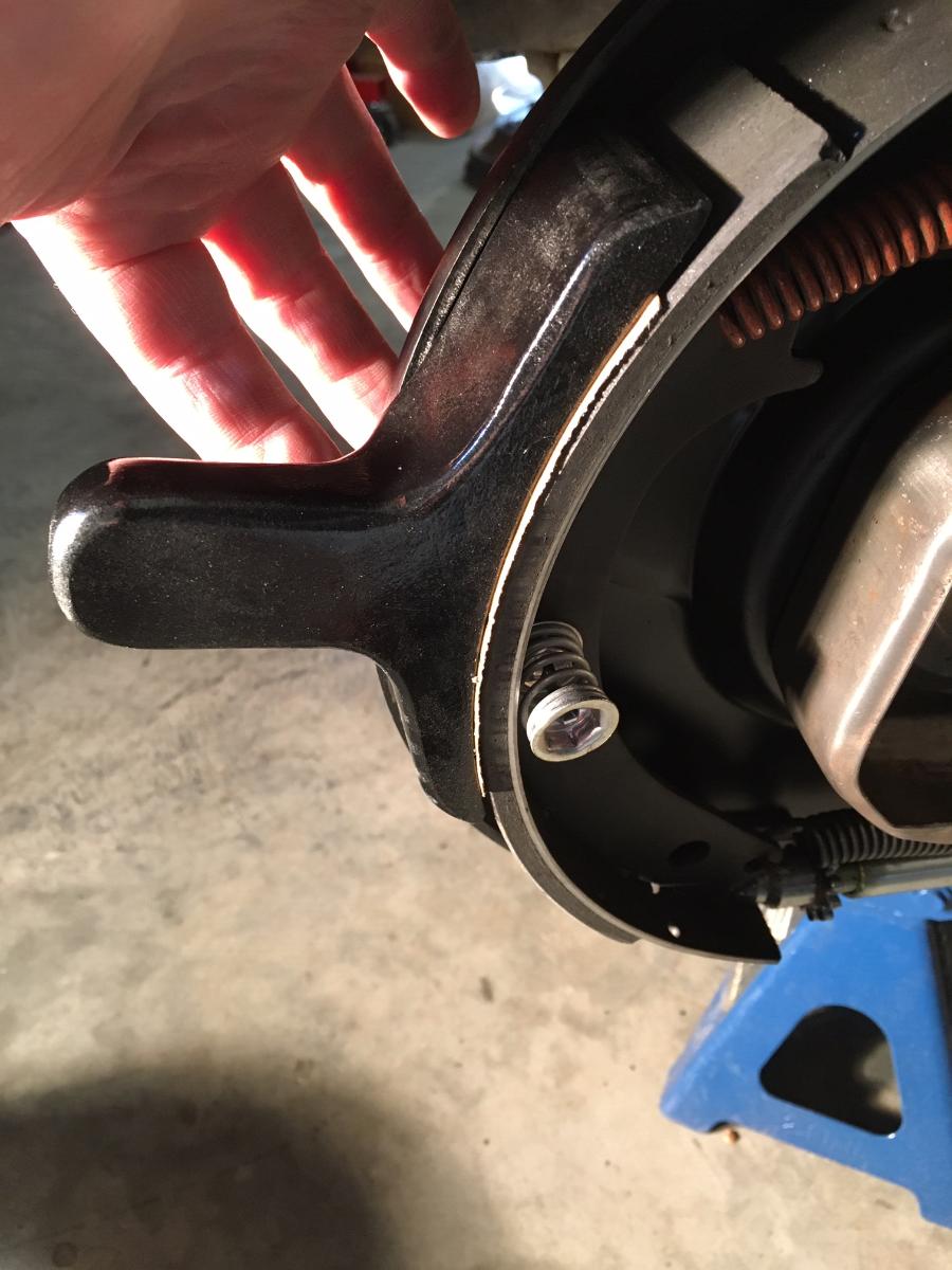

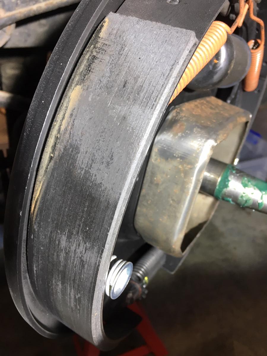

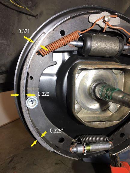

flatfoot. You say you have new brakes, and the drums were turned. I suspect that you may not have had the shoes "arcd" (radiused) to match the larger drum diameter. If this is the case, you will have limited lining to drum contact. As well, the shoes and drums will flex, because the lining is only contacting the center area of the brake drum path. Pull all the drums and check the contact pattern on all the shoes. I had this problem with my '46 Coupe when I installed Bendix style brakes, and had to make a tool to sand the linings by hand, as there is no shop in my area the can do the job. I had to do the job twice, before I got contact patterns the were acceptable. Yes, it is a pain having to pull the drums.

flatfoot. From the title of your post, I knew that you had mechanical brakes, and I have no knowledge of how they are adjusted. The issue I was referencing, was the contact area of the linings to the drums. Low contact area may not be the whole problem, but could be a factor. Have you checked what contact you have?
