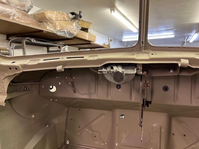

  This looks like the only place my wiper motor will attach to the frame, but placed here, the drivers wiper arm is to short and the passenger wiper arm is to long. Can anyone show me a picture about where it should go?
Thanks!

  The 38-39 restoration book covers wipers and linkage. When the motor is parked the pivot arm is horizontal. The wiper arms will point to the center of the car when parked.
