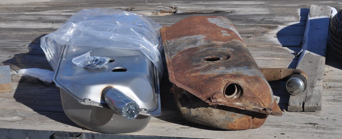

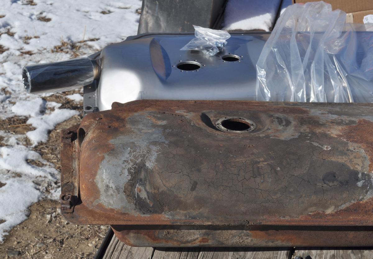

As much as I like stainless steel, I can't recommend the Stainless Steel tank that is offered for the '36. The hole(s) for the sending unit do NOT line up with the access hole in the trunk. The sending unit is not even visible through the access hole. The second hole is for the submersible fuel pump. This message was edited by Steve Kennedy on 11-14-22 @ 5:11 PM
