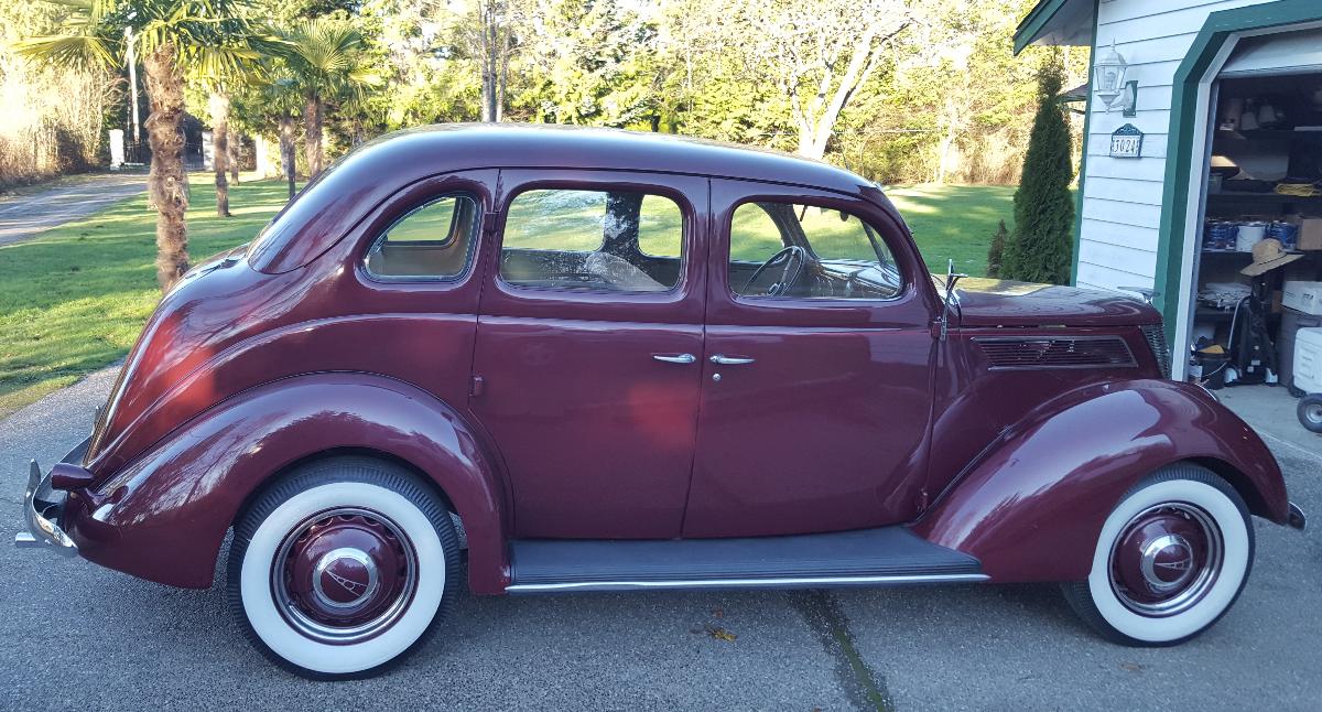

I have a bone stock '37 Model 78 Deluxe Fordor V8-85. __Unfortunately it did not come with the Columbia 2-speed rear diff. Any suggestions on possibly changing my rear end gears? The stock tranny gears seem to be pretty tall..., so I would think I could get away with putting taller gears in the rear end to get me humming up around 65-70 or so? Currently it really hums along at 50 mph, but any faster than that it's really winding out!
