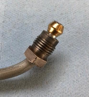

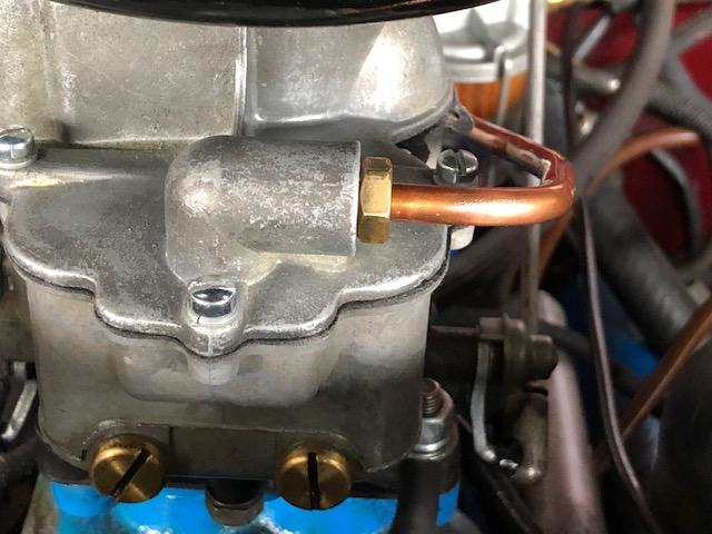

51woodie | -- 10-27-2022 @ 11:51 AM |
chucky. I had the same problem with the fuel line on my '46 Coupe. What I found was the ferrule on the end of the copper line had been compressed to the point where the hex section of the line nut was bottoming out on the face of the carb body, and not tightening the ferrule to seat properly. I had enough room at carb end of the fuel line to cut off the section with the ferrule, put a new one on, and the leak was gone. Be careful not to overtighten the line nut, as aluminum and brass threads are easily stripped with too much torque. You will see in the one picture, where the hex nut is almost touching the carb body, and the other is a nut/ferrule on the end of a fuel line. Most auto parts stores sell the ferrules for less that a dollar.
