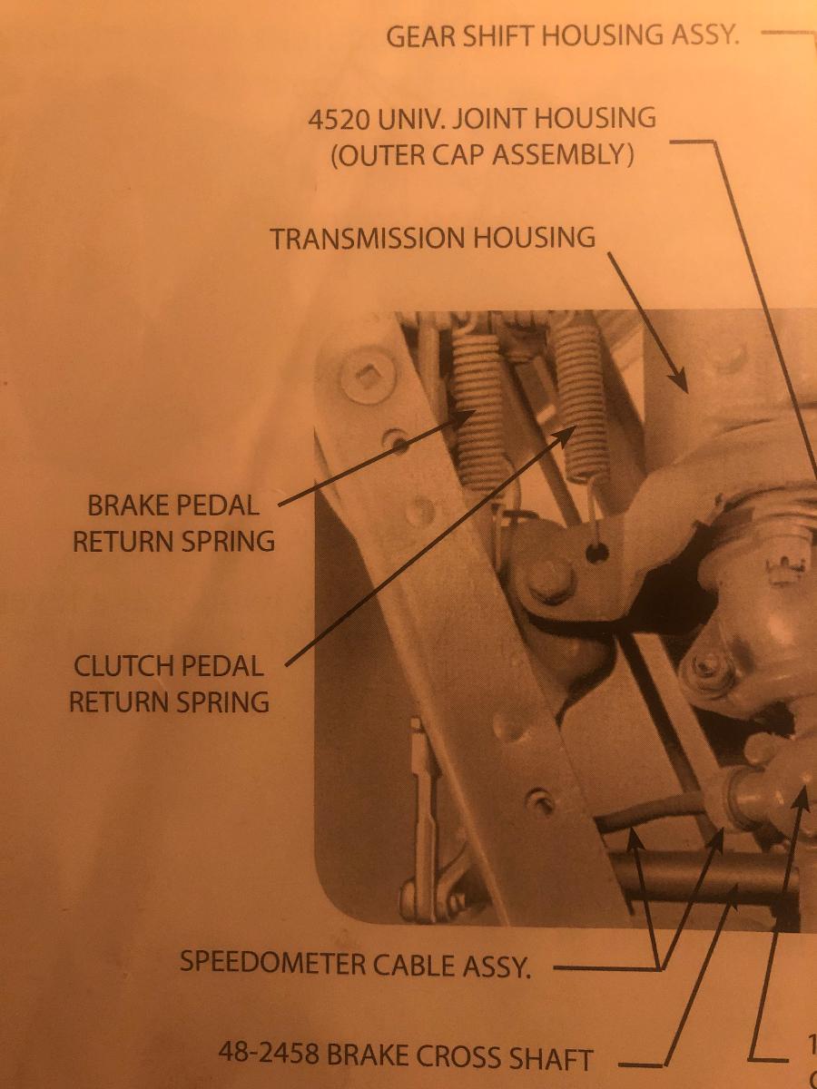

Would someone please post a photo of how the brake pedal return spring looks installed? Thanks
dean333 | -- 10-16-2022 @ 10:30 PM |
Page 82 of the restoration manual. TIM CARLIG
dean333 | -- 10-16-2022 @ 10:31 PM |
There is another one beneath the car at the front of the rear rods but that spring alone won’t return the pedal. My car was missing just the one pictured above and the pedal always stayed down. Very easy to install with left side floorboard removed. TIM CARLIG This message was edited by dean333 on 10-16-22 @ 10:33 PM
