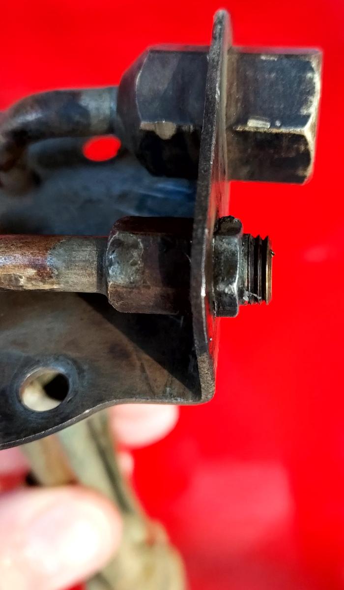

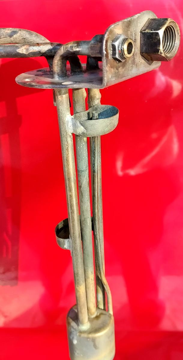

Does anyone have an idea how to fix a broken fitting on a fuel sending unit. The small fitting for the hydrostatic gas guage only has about 2 threads left. I have been searching for a used unit that I could scavenge the fitting from but no luck locating one. Don' know if it will be possible to unsolder for replacement without unsoldering the connection next to it but worth a try. Second picture is the same just cleaned up. Thanks for your suggestions, Terry
40 Coupe | -- 10-01-2022 @ 5:45 AM |
32-35 fuel senders have the same fitting and they can be repaired with a used fitting and yes they are soldered on. advertise for a used sender here and on the ford barn.
