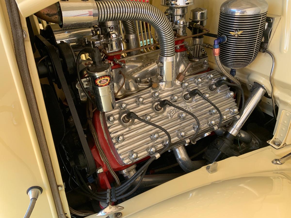

Does anyone have a set of installation instructions for the Beehive or the Standard Ford Accessory Oil Filter Kit? Maybe a parts list would also be very helpful. We have the 41 V8 in a 34 pickup. Any related information would be greatly appreciated. Thank You, Jeff Woll jeff.woll@outlook.com 678-642-4877

Looking at the pix you attached, It would appear that your question is answered in the pix. To clarify, install a T fitting in the block where the oil gauge sender is attached. Install the drain line down to a fitting into the side of the oil pan; second option is to use a special hollow banjo fitting w/a hollow 5/16 bolt into the distributor attachment location on the block.. Attached pix shows the beehive filter that is on my '36 w/59AB engine. Bill 36 5 win delx cpe
