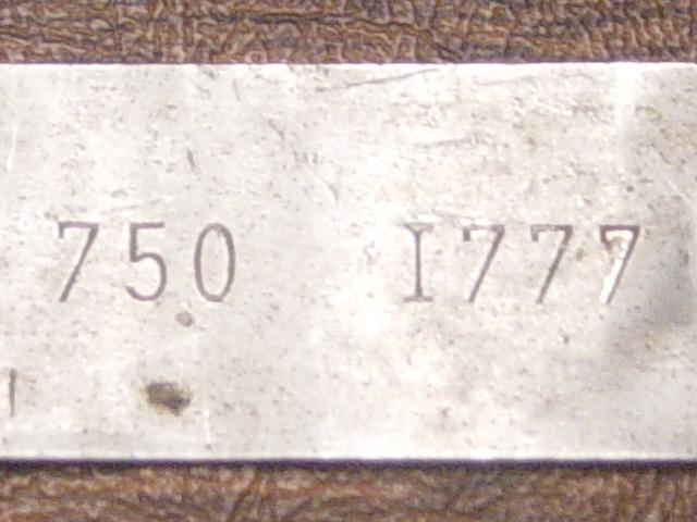

If your car has the two small holes for the body plate then the body was not assembled by Ford and the car should have the plate. The open cars body was not assembled by Ford and should have the Murray tag as seen below. The 35-36 Club restoration book has some good info regarding the plate. The number 68 is the model year for 1936 and unique to Ford. The next three digits indicate the body style 760 for Cabriolet. The last right hand numbers are the the sequential order of the body for the 760 for the year. Set up a ratio to come close to your cars approximate body number, there are no records.
